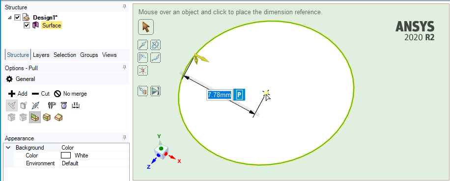

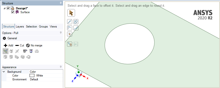

      In SpaceClaim, I have a rectangular surface with a hole in it.

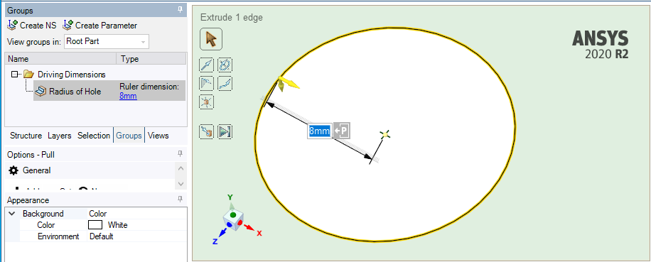

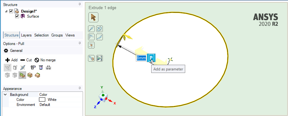

      Use the Pull Tool to pull the edge of the hole in a radial direction. Select the Ruler from the Options for Pull. Measure from the center of the circle, and click the P button to make it a Parameter.
      Give the Group a better name.
