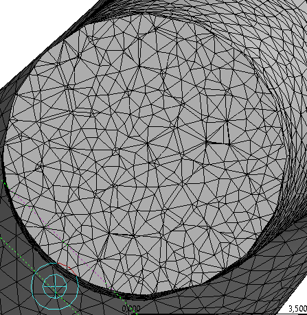

I'm using 2020R1 and facing an issue while trying to mesh a zylindrical axisymmetric object for a static structural.
Normally I would use Hex Dominant, but I get an Error saying: "Mesher has failed to generate hex dominant mesh for one or more bodies. Try using a different mesh method." This is what it looks like:

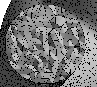

But why is Multizone not working and why do I have to use tetrahedron method? When using tetrahedron method the mesh is not as uniform as I wanted it to be. Whats the reason for that?

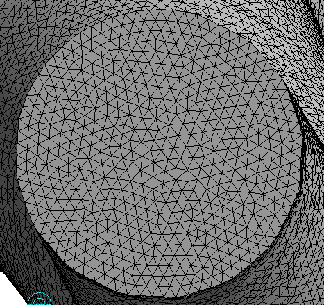

I deactivated adaptive sizing and lowered the growth rate, now it looks like this:
But the normal section view is still very unequal:
I want the mesh to look like this:
