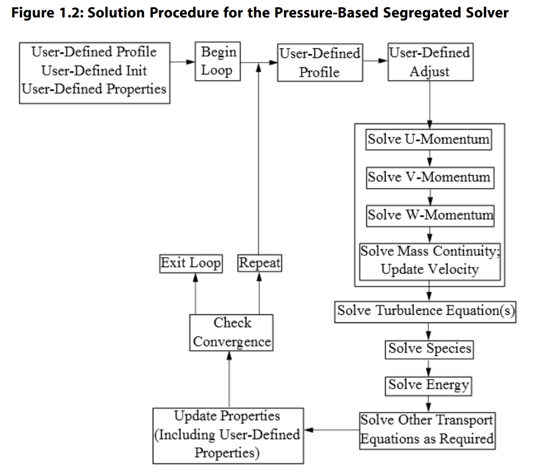

      so as the scalar moves to adjacent cells the mass flux udf acts on it and the convective velocity is modified. so suppose I want to limit the value of the species where should I do it? I am using this Solution method : Pressure velocity coupling : scheme : Simple . based on this when I look at the documentation I see this is the solution sequence
      Now based on this can you please tell me at which point in the flow chart the uds is solved. I will put a check to limit the uds to not exceed 1 at that point. Can you please tell me which udf should I use to limit the value of uds?

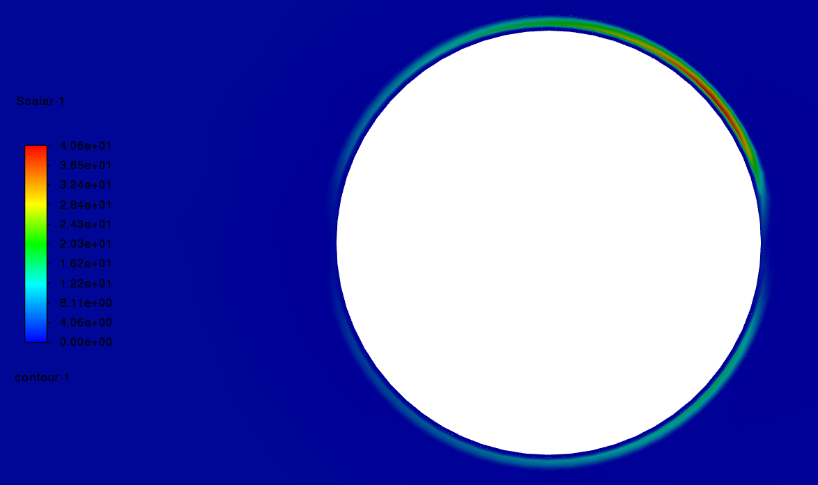

      Hey i found a way to limit the uds to a value of 1 by using execute in end. But that is not complete solution. I have two almost identical udf but one of them causes the numerical instability the other also does but it stops at 1.1.
      the uds gets accumulated around the wall in the inflation region. like this
      how to fix this issue? please let me know
      Replot with node values off. I'd expect some diffusion but also have no idea how long the model has been running, how the flow is and what your UDF is doing.

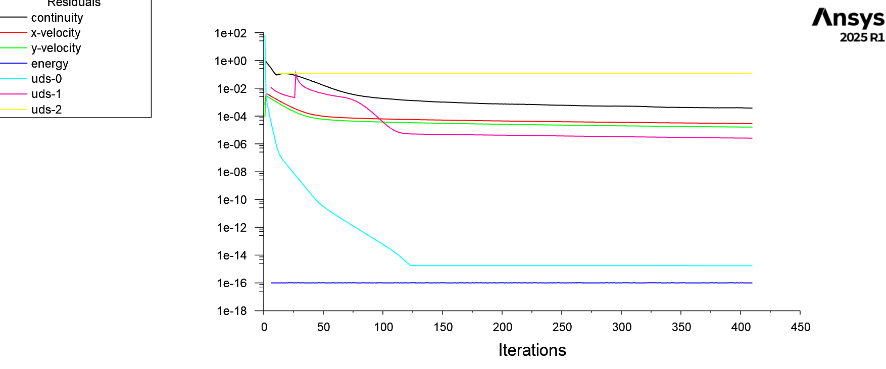

      Is there any better way of doing this? There is still one or two cells where the high number occors. The simulations are converged and the velocity field is correct
      Any suggestions would be helpful
    • Shyam Prasad V Atri
      Solutions are converged
