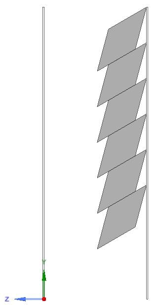

      Hi Moda,

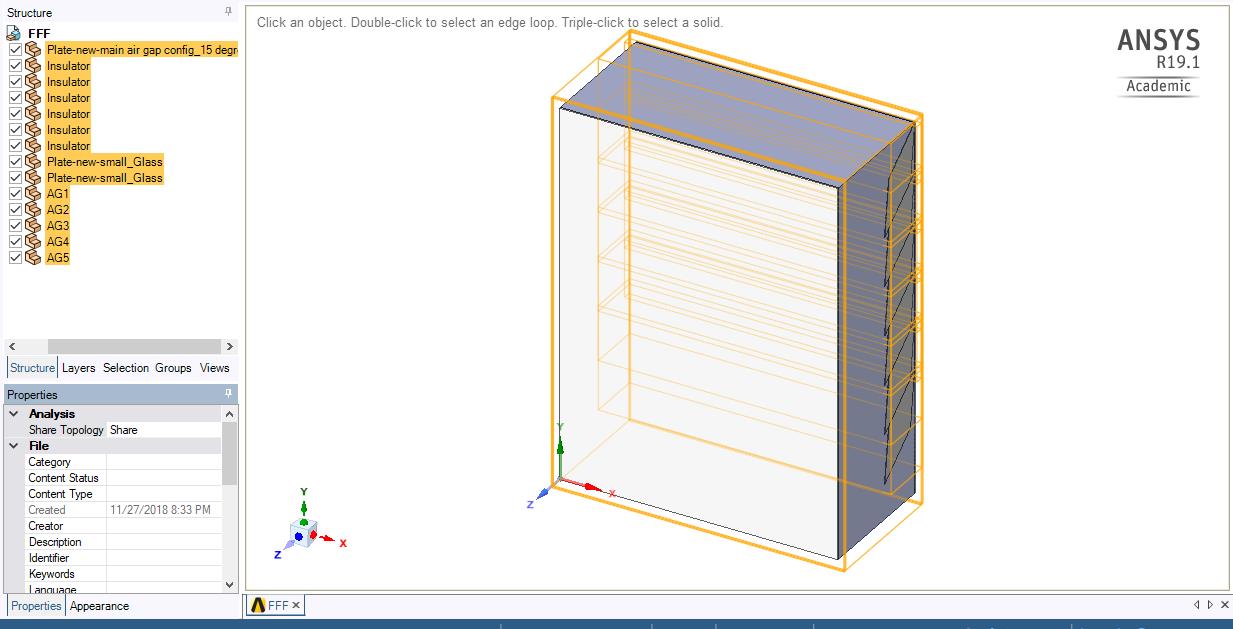

      I looked at your iges file. It looks like you have all the solid bodies shown in the left image that has two glass panes and a set of insulators and the air that is enclosed in this space in the image on the right.
      I believe this is sufficient to build a FLUENT model.

      I don't understand what you mean by an air-gap. Please create an image that points to it with an arrow, and Insert that image in your reply. Please also describe the Boundary Conditions for this problem. It looks in the image above that you want to apply a temperature to one face of the glass. I expected you would define Convection instead.
      In the image I provided on the right, that solid body is the air. It exists in the "gap" between the panes of glass and the solid insulators. I can mesh the air solid body in Meshing, then in Fluent, I can define the domain to be a fluid called air, which is available in the library.
      When you first open the iges file in SpaceClaim, you should set the assembly to use Shared Topology. That will simplify the appearance of the model in Fluent because in Meshing, it will not need Contacts that show up as Interfaces in Fluent. Instead, nodes will be shared at common faces between bodies.

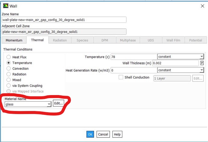

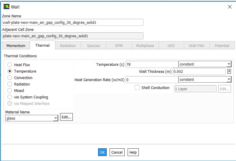

      Thank you so much for your explanation. I followed your instruction in adding a photo with more details on. Basically, two of my glass plates have constant temperature BC, while in the middle, I've cavity (air-gap) -showed by red arrows- with convection BC.
      Can you please explain to me how did you define the air domain to be a fluid called air, as it only shows me solids materials in my BCs (attached)!

      For defining air, you need to use cell zone condition.

      Dear Moda,
      If you don't want to model the temperature change through the glass thickness and want to just assume that it is constant, then Exclude from Physics the glass solid bodies.  That means you just apply the constant temperature to the face of the body that is the air directly.
      You have explained all your BCs except for the faces on the Insulators. If they are perfect insulators, then Exclude from Physics all of those bodies as well. All you will have left is the air body.  Any face that does not have an explicit BC defined is automatically adiabatic (I think).  Certainly every face of a fluid domain is automatically a wall unless an explicit BC is defined.
      In Meshing, you should create Named Selections for each face that you want to apply a BC to such as FrontTemp, BackTemp, LeftConv, RightConv.  Those names will be available in Fluent to make creating the BCs a little easier.
      I would be happy to look at your geometry if you attach a Workbench Project Archive .wbpz file to your reply.
      Peter

      Hi Moda,
      I opened the 30.iges file from your first post. I had to repair it by using Sew in SpaceClaim.
      Mechanical might automatically create Contacts in the Connections folder. Just go in and suppress them.

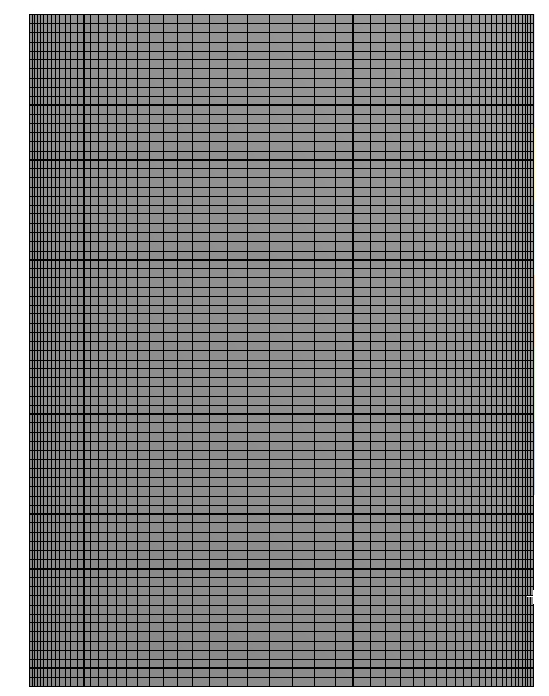

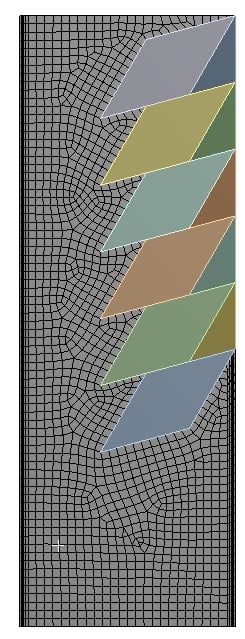

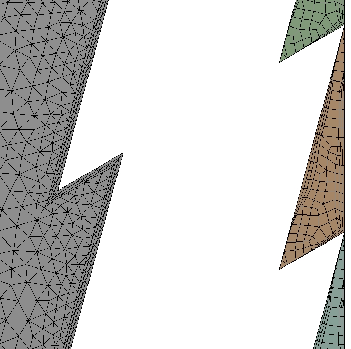

      Here is a first attempt at a mesh. It needs a lot more work to get high quality elements, but this mesh is swept from one end to the other.
      Since the five wedges on the right don't have any common area where they touch their neighbors, and since the three faces are: one constant temperature and two adiabatic, I don't see any value in making them have any shared topology or interface conditions. Aren't they just independent air wedges that have no influence on the large air cavity to the left?  In that case, there is no need for Shared Topology. Solve one wedge and you have the solution for them all.
      Peter

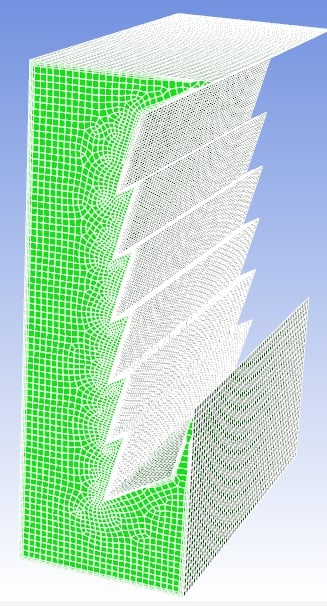

      A better mesh...
      I had to do another repair, this time Simplify. I see how fragile the import process is.
      Peter
      Here is the mesh  in Fluent.

      Regarding the 5 wedges, since they have no connection to each other or to the main air cavity, they all will behave identically, so you can just mesh one wedge to see what happens in any wedge.

      What conductivity are you assigning to the insulators? What interface resistance are you assigning to the contact between the insulators? If you don't have any extra resistance between the insulators, you should just unite the six solids into a single body. That will get rid of a lot of extra contacts in the model.
      You defined RightConv (and LeftConv), but you didn't pick all the faces that are exposed to the convective cooling on that end.
      Inflation is useful when there is a high gradient, usually in velocity, but in this model, in temperature. I suggest you only put inflation on the air faces that touch the glass. If you are sweeping, then you can use a sweep bias to put smaller elements near the convective surfaces.
      The wedge could use smaller elements than the large cavity.
      I noticed you upgraded to ANYS 19.2 since your first post.  Attached is my changes.
