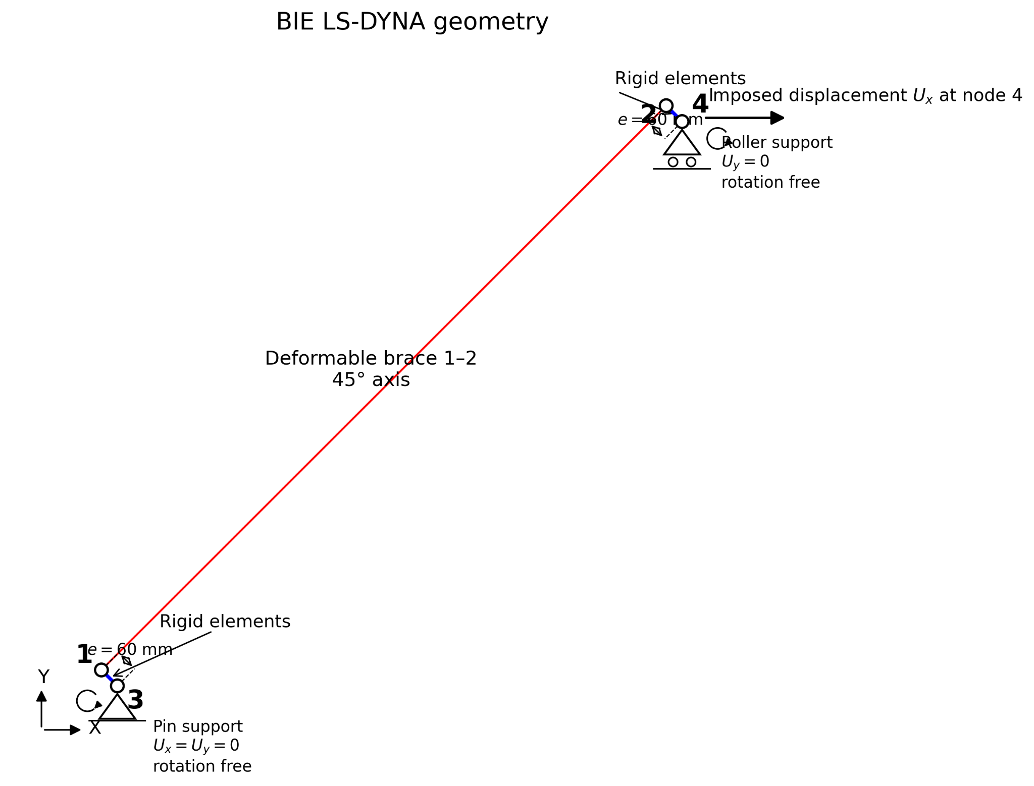

      I am trying to numerically reproduce the experiment presented in the attached paper.
      I first modeled the specimen in Abaqus as a 2D model, using constraints to represent the rigid elements. Now I am trying to build the same model in LS-DYNA, but I am having difficulties modeling the rigid elements correctly.
      I have tried using *CONSTRAINED_NODAL_RIGID_BODY with pinned supports (free rotation), but the entire assembly behaves as a single rigid body. I also tried modeling the rigid elements with beam elements having a very high stiffness, but the results are still differ significantly from those obtained with Abaqus and the experimental data.
      What is the recommended approach in LS-DYNA for modeling rigid elements between two nodes while maintaining pinned boundary conditions? Is *CONSTRAINED_NODAL_RIGID_BODY the appropriate choice, or is there a better approach?

      I don't think you can apply spc's on a Rigid Body node in LS-DYNA. Here is what I suggest you do.
      1. Create another RB with at least three nodes, say Node 30, 40, and 50, with Node 30 coincident to Node 3, and Node 40 coincident to Node 4, and Node 50 in the direction of travel of the Node 4, but at some distance apart. This RB is the ground, or the foundation.
      2. Duplicate the Node 50, and add it to the upper RB, (so Node 5 is coincident with Node 50).
      3. Define a revolute joint using Node 3 and 30 (for 2D problem, or a spherical joint for 3D problem). And Define a translational joint using Nodes 4-40 and 5-50.
      The structure now should work as intended.
    • yti2024
      Sorry, for the upper joint, it will be a cylindrical joint using two node pairs; this allows sliding and rotation (3D). If you want a translational joint, you need add a third nodal pair to define the direction (out of the plane). (This will limit your problem to 2D). (I am not looking at the manuals, but you get the idea).

      Sorry I cannot comment on what you should do or not do on your full model becasue I don't have much idea about it. However if you think the deformation of the parts is negligible and the motion of the parts follow strictly as if they are in an FE joint, then I think the RB and Joint is a good simplification of the real problem. In large deformation, these conditions are often hard to meet.
    • yti2024
      For your original question, if you can, instead of rigid, use elastic material for the two rigid parts, then you can apply spc's on the nodes. Modeling wise, this is easier.
