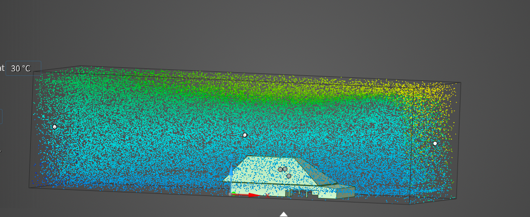

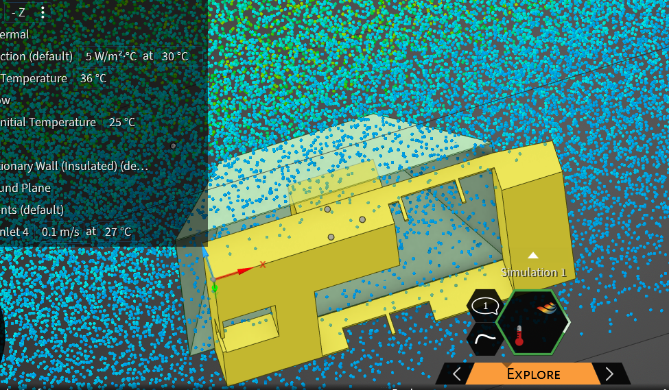

In the setup you have created, I do not see any specific heat source.
 Can you please explain your setup in more detail?Â
Are you trying to assign any temperatures or heat flux on inside walls?Â

I am simulating an open ceiling building (wind + heating roof) + (attached with a whirlybird turbine atop)
but in this stage i cant seem to simulate a heating roof, to capture a real life environment (temp) happening inside the buildingÂ
can you help me with this pls?ÂÂ
thank youuuuu
edit: ive tried eating heat flux or heat source but it doenst seem to work. im confuseddd
