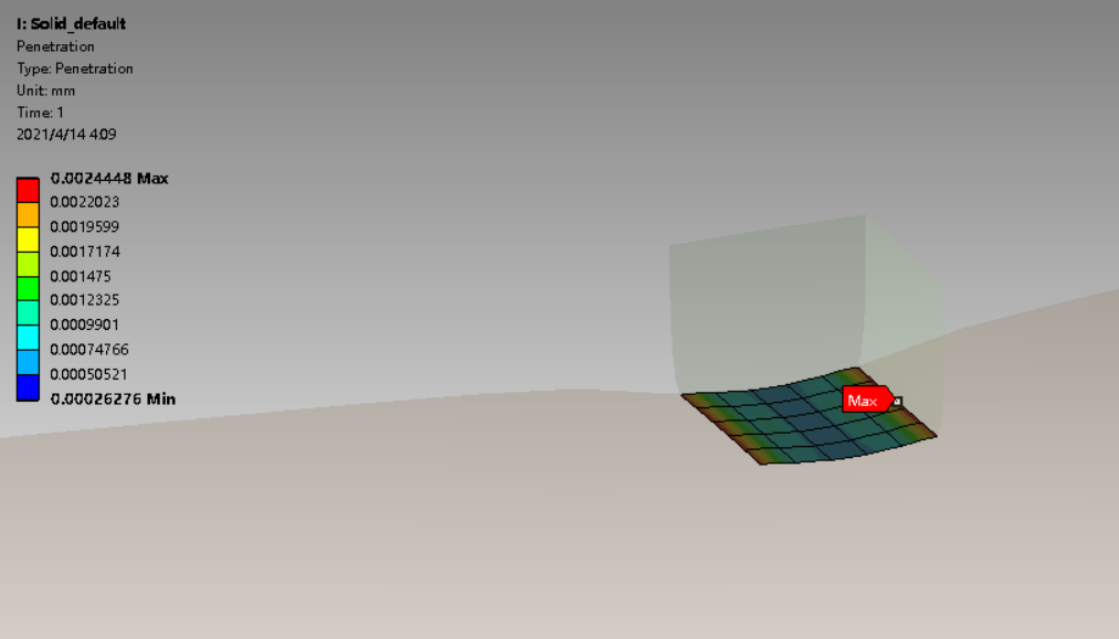

SubscriberHi, I'm trying to apply force to one object through another object over a small area using solid elements. I was hoping that stress singularity does not occur since I'm using solid elements rathan than a point load, but I still have super high stress at the point of loading. I think I am using the wrong contact setting because I have pene-tra-tion between the two objects, as shown below. Could someone please advise how to model this interface correctly to avoid stress singularity? Thank you!
April 15, 2021 at 6:05 am1shan
Ansys Employee,nA small amount of penetrtion is acceptable for most of the problems and is a unavoidable consequence of the augmented lagrange formulation which enables ease of convergence. As far as the singularity is concerned, will the stress concentration at the edges have a significant effect on the results, in the area of interest? If no, you could simply ignore them. If yes then you could give a small fillet radius at the edges and apply a mesh bias with more elements near the edges.nRegards,nIshan.nApril 16, 2021 at 1:48 amAslinn
SubscriberThank you for your reply. That makes sense. Yes I checked other points away from the loading point and they are all fine.nViewing 2 reply threads- The topic ‘How to model contact to avoid singularity?’ is closed to new replies.
