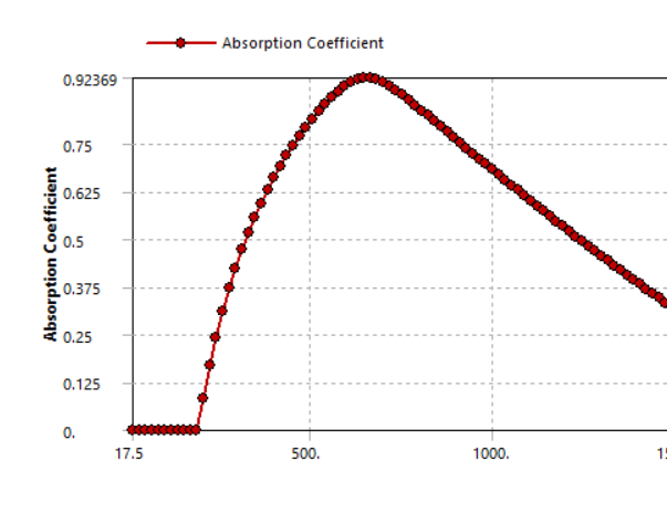

      I have modelled a unit-cell of an anechoic structure in harmonic analysis. The layer is silicone and has been assigned as an acoustics physics region, with an air cavity inside (the air has been modelled and also assigned as an acoustics physics region). There is a steel backplate as well that is structural. In order to simulate the water closure on the silicone layer face I have applied an impedance boundary condition, assigned a port to this front surface and used the body of the same layer to assign the inside surface bodies. A planar wave has been applied using a 'port in duct' excitation condition (with 10000 Pa) and the acoustic absorbance is calculated.
      I have used the same material parameters that I have seen in many papers, however I am getting very different results and wondered if anybody could please highlight where I have modelled it incorrectly or explain the observed behaviour? I am assuming there are certain boundary conditions I haven't applied. I have included an image of the absorption coefficient with regards to frequency in a 0-6000 kHz range.

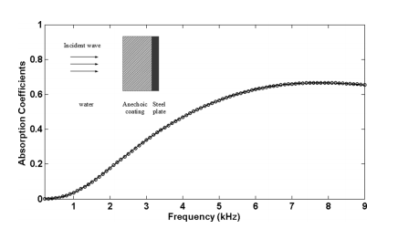

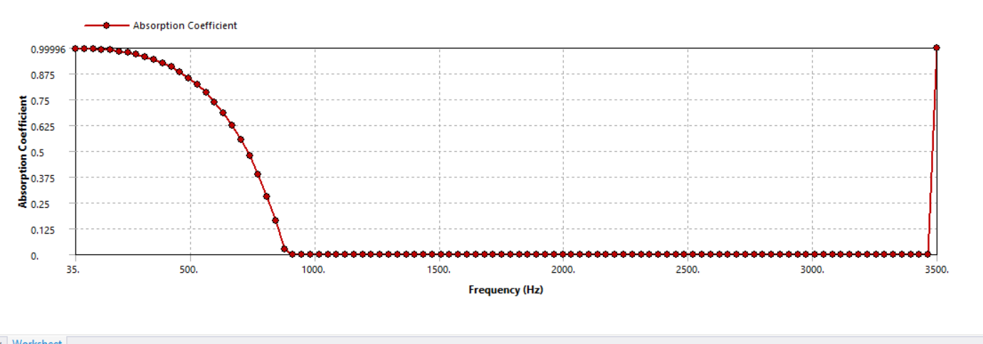

      Yes of course! Since posting the question I have made amendments (namely changing the anechoic layer from compressible to incompressible) and this is the result I get:nHowever, this is the absorption coefficient graph realised in the literature:nAs you can see the behaviour displayed by my model is completely different. I have used the same material parameters, and have used the same equation to calculate the impedance for 100 values between 0-3500 Hz. Little other information about how the structure was actually modelled is given in the paper, though I think one big difference may be the wave speed used. I have used a value of 50.3 m/s for the speed in the silicon layer- they haven't stated what was used during simulation but the wave speed used to calculate impedance in both their and my model is 325(1+0.11i). As far as I am aware there is no way to input a complex number for wave speed in ANSYS. nI am not sure how to amend my model, though it is clearly incorrect. Any help is greatly appreciated.nThank you, Callum.n(Reference: Xinyi Fu, Zhongkun Jin, Yao Yin, and Bilong Liu, 'Sound absorption of a rib-stiffened plate covered by anechoic coatings'.)n
    • calENG
      Sorry, I forgot to say as well that for the results above there is no air cavity modelled.n

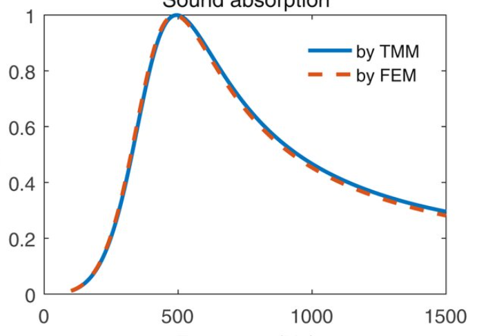

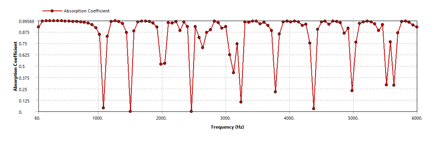

      Hello, thank you for your reply. I believe I have sorted the issue I was having. The impedance I was using was incorrect, and so I have sorted that and applied it to the Ansys model and am achieving much better results. I have included an image of the result I get compared to a similar set up given in literature.nMy result:nnThe result given in the literature:nI think the difference may be explained by the wave speed and the loss factor used, I'm not sure what values they used for this but the result follows the same trend.nnThank you.n
