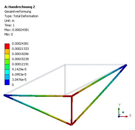

Is there an easy way to model a rotatable joint of a truss construction? In Mechanical i just found the way of freeing some degree of freedoms, but this is not working at supported notes (nodes 1 and 4 in the attached file).
How am I supposed to do this?
I'm using Ansys 19.0 student edition.
Thanks!

In your truss, you show two points connected to ground. Both points cannot have a spherical joint to ground, because then the truss would be free to spin around the line connecting the two points. At least one of the two points has to fix a rotation that would prevent that motion, or a third point, not on the connecting line, would need a constraint to prevent the spinning.
How did you free some degrees of freedom at nodes 2 and 3?

thanks for your fast response! I think I have to add some information. My goal is to model the behavior of this beam-structure as there would be some rotational joints at each node.
I tried to solve the problem in two ways:
1) I assembled the whole structure in SpaceClaim and free the rotational degree of freedom at nodes 2 and 3 with the tool (contacts/joints => free degrees of freedom). There will be a result, but the system is still behaving as the nodes would be welded. (see attached file "way1") There was somehow no failure message because of the rotation you mentioned above.
2) I tried to handle the five beams as a single structure and join them in Mechanical by locking the rotational degree of freedom. But I couldn't find a proper way to do that. (attached file "way2")
Thanks in advance!
Maetha

I haven't used beams much and when I did, they were "welded" together into one big structure.
I have used your problem to explore how to connect beams with joints. Attached is an ANSYS 19.0 archive that has two beams that have a fixed support at one end, have universal joints in the middle, and have a displacement BC at the other end. This is a different method than your "beam release" method.
I don't yet know how to have three beams come together at a common intersection.
Don't know if this is useful. I would like to understand your beam release method.
Can you attach a project archve?

peteroznewman
SubscriberHello Deepak,
You are getting a pivot error with the universal joint because the center beam has no connection.
This is the reason for the extra body. You need a body to connect a universal joint from each beam coming into the corner, so there would be three universal joints on the top corner body and three universal joints on the bottom corner body.
If you drop a Modal analysis onto the Model line of this project, then in Mechanical, drag and drop the Fixed Support onto the Modal system you can solve and see all the beams that are loose.
If share topology is used, then the beam ends get welded together, then this becomes a weldment and beams will experience bending loads. A true truss carries only tension and compression and no bending moments are put into the links.
