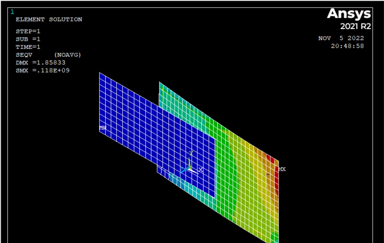

      Hi all,
      I want to model a delamination in a composite shell. For this purpose I want to use element  shell 281 in ANSYS apdl. I meshed two plate exactly in a same location but with different defined cross-sections. I defined contact between them through preprocessor>modeling>create>contact pair, but when I apply force nothing happens between them (only one-sided deflection appears).
      Do you know where the problem is?
      Any comment.

      Check the contact normals to make sure they shells are oriented properly with normals pointing to each other. This is the first thing I would try.

      I did so, but no succsess. I enclosed file. you can check.
      Let me know if there is any sample example for shells contact in Ansys apdl I look at?

        So, it might be happening is you are loading too quickly and the contact is not detected.  You should turn on auto time stepping (autos, on) and then set the NSUBST command so that you are breaking the load into smaller amounts (set min, max, and initial), as what could be happening is the force you apply is enough to push the parts beyond contact (larger than the contact pinball region).
        Please try this.
