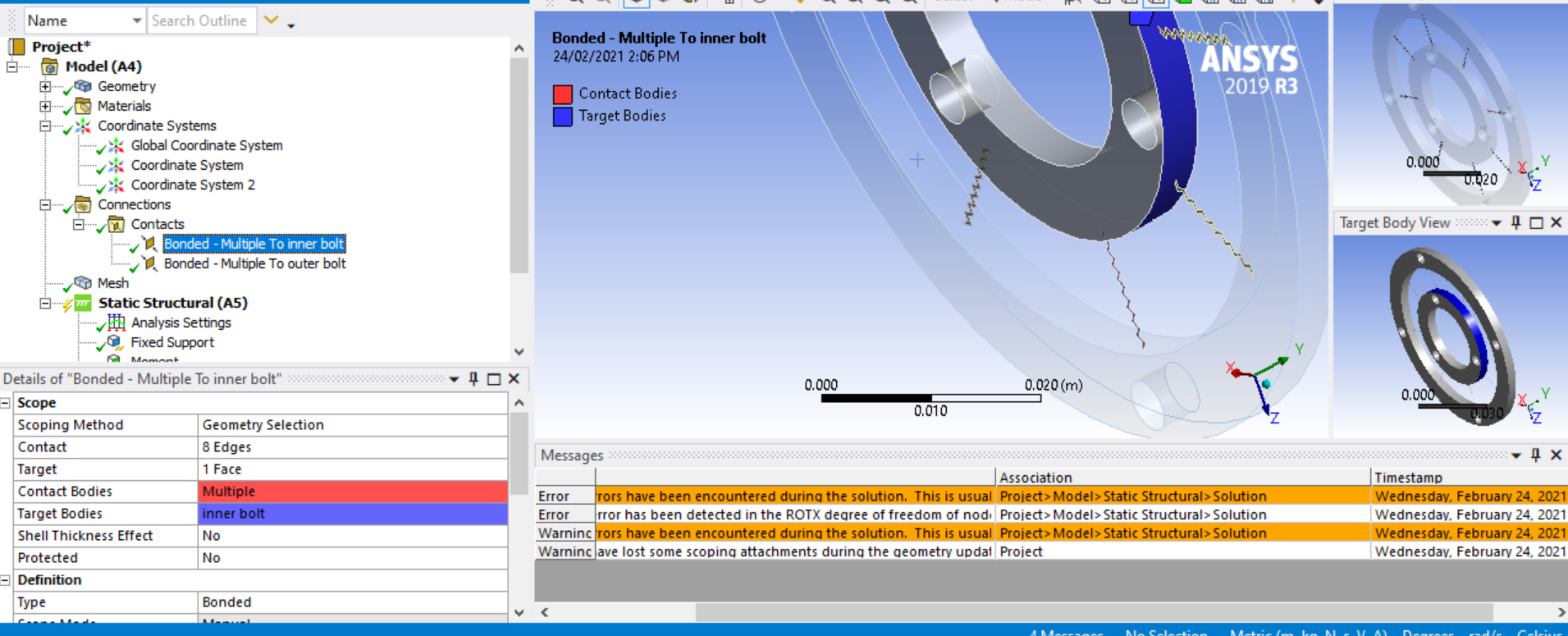

SubscribernSlice the inner and outer rings to separate them from the springs.nUse midsurfaces for the zig-zag springs and mesh with shell elements.nUse Bonded contact to connect the last edge of the spring to the face of each ring.nFebruary 24, 2021 at 3:08 amas880

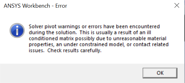

SubscriberHi 1shan and peter, nI have created the shell models of springs and then used that to generate the mesh but it is giving me this error messagesn
I want to get a result of directional deformation in the y-axis of a cylindrical coordinate system to calculate the degree of deflection of the spring. Please Help. Thanks alotn

SubscriberFebruary 26, 2021 at 3:01 ampeteroznewman
SubscribernI see there are two interpretations of midsurface on your solid geometry. I was thinking that the midsurface would go in the other direction, but what you did is also valid. If you take the approach suggests, you can collapse the model down to a 1D elements instead of 2D elements, and that is also a good approach.nIn either case, you use bonded contact to connect the meshes together. You should insert a Contact Tool under the Connections folder and Generate Initial Contact Status. Check that the contacts are Closed. If they are not, you may need to input a Pinball Radius to make them close.nViewing 5 reply threads- The topic ‘How to mesh very thin elements’ is closed to new replies.
