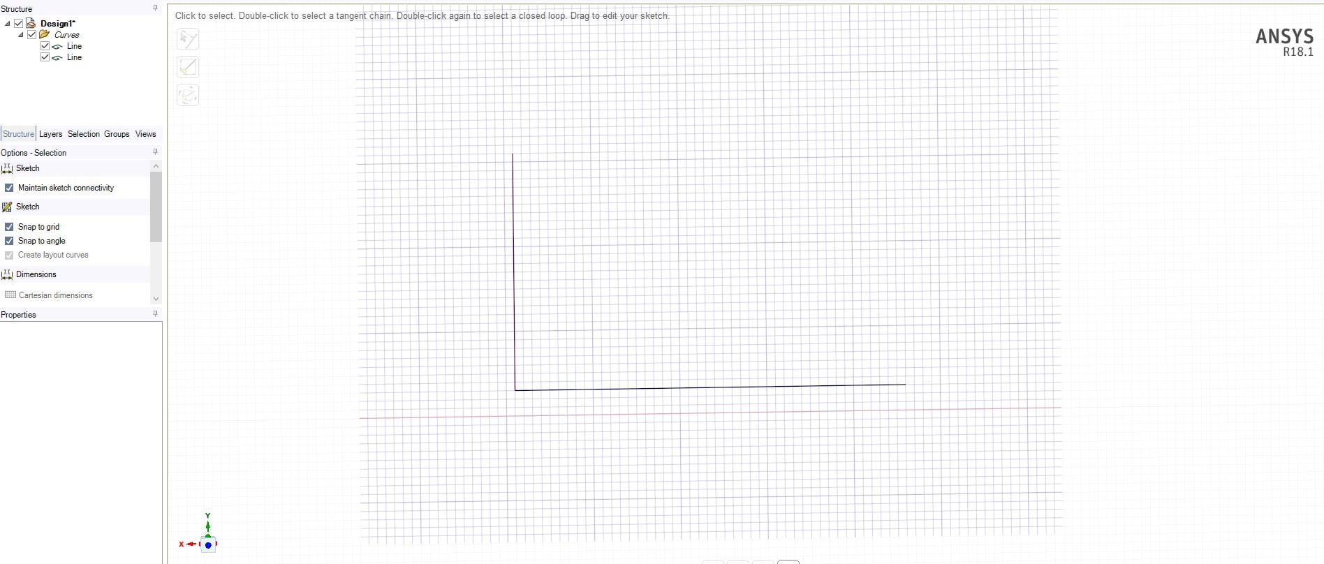

 Is this for SpaceClaim or Design Modeller?
 In SpaceClaim, see if the Combine or Fit Curves tools help?
Sandeep
October 12, 2018 at 8:13 pm
Sam Fares
SubscriberSandeep,
It's for SpaceClaim.Combine or fit curves dont help unless i am doing something wrong.
Thanks,
Sam
October 12, 2018 at 8:45 pm
Sandeep Medikonda
Ansys EmployeeSam,

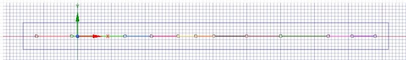

 So, Fit curves should work. Below, I have 3 lines.
I then selected the Fit Curves option to join
Alternatively, you can also use the Fill tool as shown here:
Hope that helps.
Sandeep
Best Practices to post on the Student Community -
October 12, 2018 at 8:54 pm
Sam Fares
SubscriberSandeep,
yes it worked. i forgot to check the check mark.
Sam
