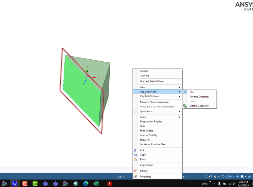

      • Ethan Geometry Rabinowitz
        PARVEEN SAHNI You can only select things/faces in section mode that cross over the section plane.  if you are trying to measure something behind the section plane that doesn't cross over the section plane, you won't be able to select it
        You can either project to sketch (sketch group of tools) in sketch mode and measure that
        Or stay in 3D mode and add a datum plane (design tab) where you want the section.  Right click on the plane and go to "clip with plane" and set it.  it will clip the view and you can select anything visible.  You can flip the clip direction from the same menu

      I had one more question, Right now I see there is specific standard option to insert a datum plan for instance, insert a plane in middle of surface, insert a plane in middle of two points. However, is there any other option in which it is possible to move the datum plan parallel to screen as we move the plane in section mode ?
        PARVEEN SAHNI great!
        The tricky part is the default way is to use the move gird button at the bottom of the screen, but that requires dragging and you can't drag perpendicularly to the screen
        you could click on the arrow, rotate the view normal and type in a value.
        Or you could use move to setup a parameter in the groups tab that moves the plane in that direction, then update the value in groups
