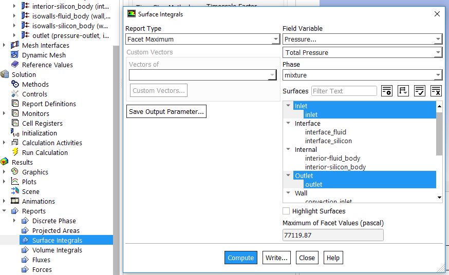

Ansys EmployeeMake area weighted average of total pressure at inlet and outlet in separate report definitions. Then create a new report definition of type expression where you make the difference between both report definitions.
December 15, 2018 at 12:00 am
mossaied2
SubscriberThanks Mr Amine, but how about the max pressure?
Also if I have a surface and I wanna report the temperature at some points (say 10 points that I know their z,y,x coordinates) on that surface, how to do that?
Thanks
December 15, 2018 at 7:56 am
DrAmine
Ansys EmployeeSame but with facet maximum at the boundary.
For points you create them based on theier coordinates and evaluate them via vertex average.
