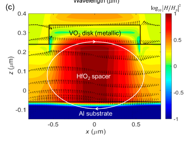

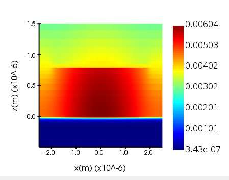

      The picture on the left is the result of the literature reference, and the picture on the right is the result of my simulation. The first question is how to obtain the same range as the left picture for the color scale on the right after simulation. What impact does this range have on the result analysis? Why should the color scale value be processed as E/E0? The second question is how to draw a two-dimensional diagram of electric and magnetic fields like the one on the left?

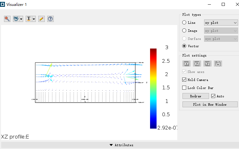

      Thank you for reaching out to us! You can edit the scale by clicking the pencil button on the visualizer window:
      As you cans see on the picture above you can change from linear to log scale or change the axis limits. Regarding your questions: What impact does this range have on the result analysis? Why should the color scale value be processed as E/E0? I believe this depends on you and how you want to present your results. On how to draw a two-dimensional diagram of electric and magnetic fields like the one on the left? Please have a look on our article How to put a vector plot and mode field plot together from your MODE simulation.

      load C:/Users/Neo/Desktop/y_1027.mat;
      x =lum.x;
      y =lum.y;
      A =lum.z;
      colormap jet ;
      x2 = linspace(min(x),max(x),701);
      y2 = linspace(min(y),max(y),519);
      [X,Y] = meshgrid(y,x);
      [X2, Y2] = meshgrid(y2,x2);
      A2 = interp2(X,Y,A,X2,Y2,'nearest');
      A3 = A2.';
      imagesc(x2, y2, real(A3));
      set(get(gca, 'XLabel'), 'String', 'x(m)')
      set(get(gca, 'XLabel'), 'FontSize', 16)
      set(get(gca, 'XLabel'), 'FontWeight', 'bold')
      set(get(gca, 'YLabel'), 'String', 'z(m)')
      set(get(gca, 'YLabel'), 'FontSize', 16)
      set(get(gca, 'YLabel'), 'FontWeight', 'bold')
      set(gca, 'XLim', [-2.5e-06 2.5e-06])
      set(gca, 'YLim', [-5e-07 1.5e-06])
      set(get(gca, 'Title'), 'String', '')
      set(get(gca, 'Title'), 'FontSize', 18)
      set(get(gca, 'Title'), 'FontWeight', 'bold')
      colorbar;
      set(gca, 'YDir','normal');
      Thank you very much for the learning materials provided, but I still failed to get the expected result. The above code is my simulation result FDTD output of matlab to draw the magnetic field diagram code, may I ask how to combine with the electric field vector code linked by the example to draw my results
    • Niki Papachristou
      HI JL Y,
      I believe you have to experiment a little bit with the commands here. Based on the example above I think you might be missing the
      hold on;
      quiver(xmesh*1e6,zmesh*1e6,real(Ex2),real(Ez2)); % vector plot
      commands for your respective parameters.
    • JL Y
      How to output Vector data, do not seem to see the output instruction
