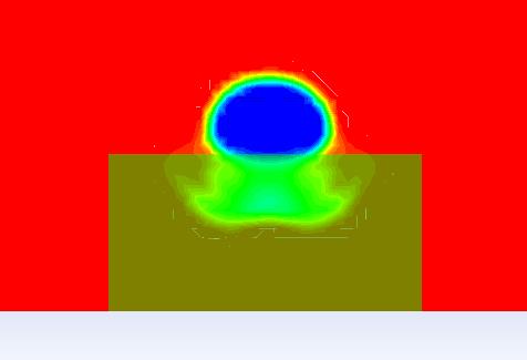

      HI,
      I used the VOF and solidification and species transport model. the reactant gases are phase 1, the material I want to melt is phase 2. Reactions happened on the porous zone surface to improve the temperature. phase 2 is patched right on top of the porous zone. everything looks good until many steps passed. phase 2 deformed from rectangle to ball shape because of surface tension. However, partial phase 2 sinked into the porous zone. If I activate the gravity, more phase 2 would be going inside the porous zone.
      How can I make the porous zone to be kind of solid, so that phase 2 only deformed on the surface of the porous zone?
      Thanks!
      In the attached picture, the green rectangle is the porous zone, blue/green/yellow part is phase 2 I want to melt. the red part is phase 1 of gases. this is simulation without gravity.
      Try setting the top surface as a porous jump, I think you can then set contact angle. Also significantly increase the phase 2 porous resistance coefficients. You'll still get some diffusion but hopefully not too much.
