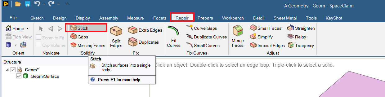

      Can you try using 'Stitch' command from the Repair tab in SpaceClaim or Discovery to create a body out of the surfaces.
      Nikhil

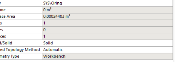

      if I use designmodeler (DM) import 3D to geometry, how could i fix the components that don't have volume, shown as below
      also, i used 'Stitch' command to repair the model, then it keeps non-solid ?

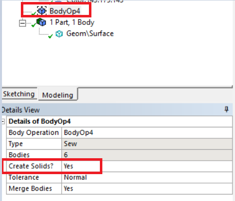

    • Akshay Maniyar
      Can you try using ‘Body operation’ option under ‘Create’ Tab in DM? Also, make sure that ‘Create solid’ option is set to yes.
      Also, as Nikhil suggested you can use ‘Stich’ option under spaceclaim to stich the surfaces and convert the surface bodies to solid body.
      Thanks,
      Akshay Maniyar
