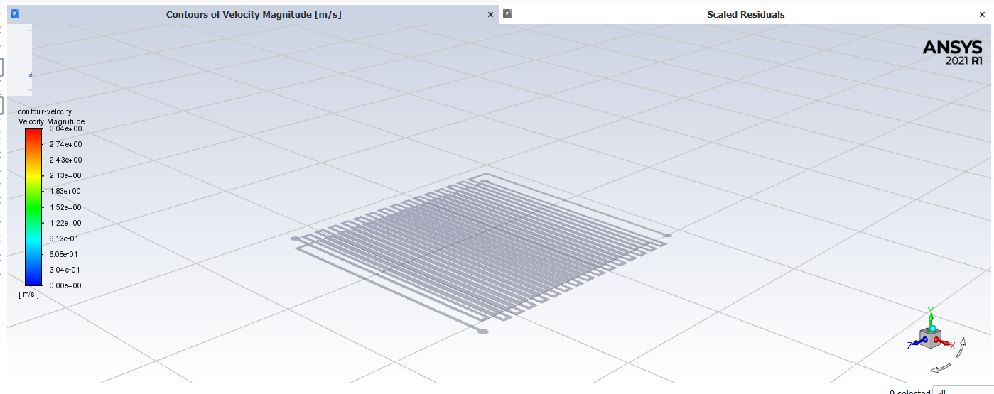

SubscriberI am trying to display contours on plane surfaces when visible from +x, +y, +z. They are only visible from -x, -y, -z. Does anyone know how to fix this?

SubscriberHello,
I could rotate the model, but would like to keep it consistent with other simulations I have run.
Sean
November 3, 2021 at 12:11 amkarthik.remella
AdministratorPlease set the view you wish and then save the view. Views -> Views -> Save
You should be able to 'Apply' the view as necessary.
