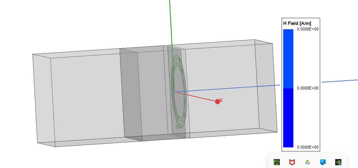

      I am trying to simulate a split-ring resonator with a uniform static magnetic field being applied to it. I start by creating a ferrite material where I assign some value for the magnetic saturation. I end up with a geometry like the one below. The two large boxes on either end are vacuum and have radiation boundaries assigned to their faces. The rings and the square behind them have a perfect e boundary applied to them. I have a lumped port excitation on the SRR. The ferrite material is the slighlty larger box behind the SRR. It has a magnetic bias excitation applied to it. I assign an internal bias to it and then give it a value for the permeability tensor rotation. After I run the simulation, I am getting no magnetic field from the ferrite material. Can someone explain to me what I am doing wrong? Also, I wasn't sure how the permeabiltiy tensor rotation affected the direction of the magnetic field. I figured I would mess around with it and figure it out, but if someone knows and wants to save me some time that would be amazing. There are a x, y, and z angle for it. I would appreciate any help.

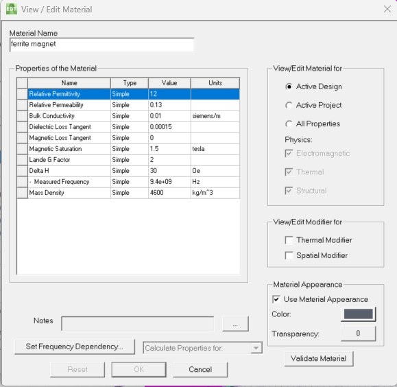

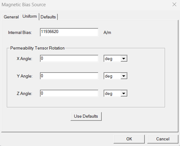

        Thank you. That helped some. I changed the properties to be more similar to the example. I also moved the ferrite material back a little bit so that it wasn't touching the ground plane as that is more similar to my actual experimental setup. The ferrite material now has an organized mageneti field; however, it is just organizing based off of the magnetic field of the SRR. I need it to behave as a permanent magnet. I have attached images showing my material properties for the ferrite and the magnetic bias setup. I believe I have it setup correctly, but are there any obvious errors you see? I want the ferrite "permanent magnet" to have a field in the z+ direction.

      I don't see anything illigal with the material definition. I am surprised with permeability much less than 1, but with non-zero MS value, the permeability is overridden with the Ferrite Permeability Tensor based on Polder  model. Search "Ferrite Permeability Tensor" in on-line HFSS Help for detailed formulas. Magnetic Bias source as shown is set to be along Z axis.
      Note that when you plot H-field in HFSS, you don't plot DC external field but RF H-field. HFSS solves for E-field (as complex vector) and then deribes H-field based on Maxwell eqs. and solved E-field.
      If you still think that RF H-field is too small, see that the power is actually entering the design. How S-parameters look like? Can you plot E-field? Is it as expected?
