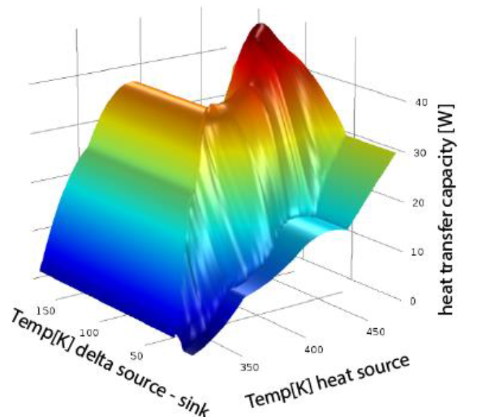

      In my simulation I have to apply a heat transfer capacity. This has been determined in a real test and depends on the temperature at two points on the model.
      The following graph shows the measured data.
      My question now is how can I load the measured values into Ansys?
      And when this is done, how can I assign the heat transfer capacity so that the correct value is retrieved for the respective temperature?

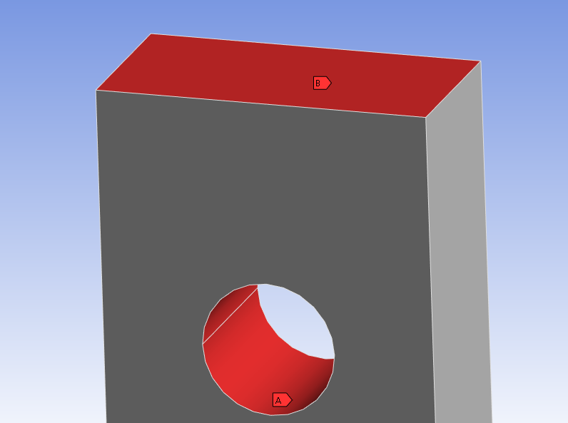

      thanks for the answer. I would like to simulate the time course of a cooling process.
      A temperature load is applied to surface B. The temperature in the center of the surface should also be the source temperature.
      The heat sink temperature is constant as you have already assumed.
      On the surface A the body is cooled and the temperature is extracted. For this I wanted to create a heat flow with the values from the graph.
      The heat flow is actually the output of a heat pipe and the values were determined experimentally.

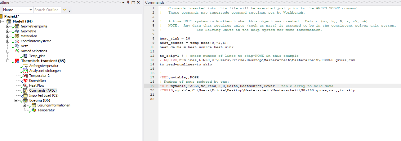

      Unfortunately, I still have to simulate it anyway. My approach would be to add an APDL command to the loads. Then I read in the values and pass on the corresponding heat flow.
      Would this be possible with this process ? I just want to be sure before I spend the time to learn the relevant apdl language.

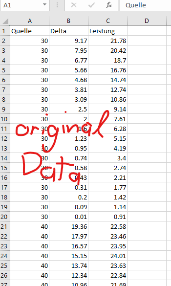

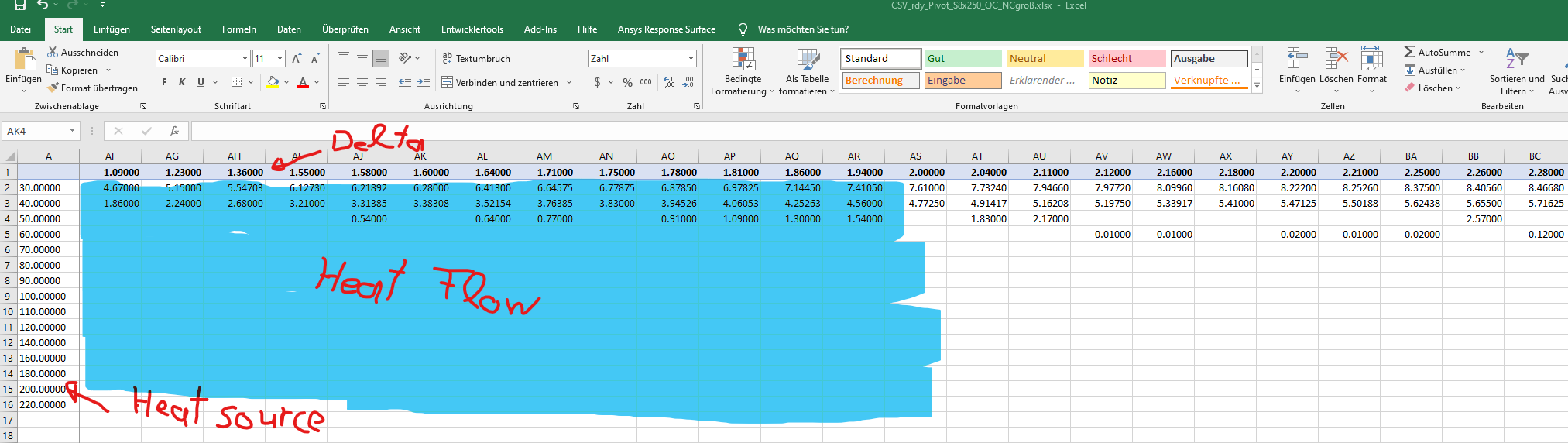

      For this I have prepared the data in excel as follows.
      I interpolate the gaps between the values in excel. The empty fields at the edge are filled with 0.
      The original data are created in 3 columns. This means that there are duplicate values. I think ansys can't work well with this so I converted the values to the format above.
    • dlooman
      Is the heat flow just a function of the delta or is it a function of the two temperature.  *TREAD creates an indexed array in which column 0 (column 1 of the file) and row 0 (row 1 of the file) are indices.  In your case the indices are the two temperatures.  So the first column of the file should be one of the temperatures and the first row (skipping column 1 since this is really column 0 should be the other temperature.  The data associated with each pair of indices is the heat flow.  It is possible to run many solves in a do-loop, and update the heat flow before each solve.  The heat flow would be retrieved based on the indices, heat_flow=table_name(temp1,temp2).

      Thanks to your help the apdl snippet works very well. I have implemented it as follows:
      heat_sink = 20
      to_skip = 0 ! enter number of lines to skip (if titel column or sth.)
      /INQUIRE,numlines,LINES,C:\Users\...,csv
      to_read=numlines-1    ! Number of rows reduced by one
      *DEL,mytable,,NOPR
      *DIM,mytable,TABLE,to_read,1196,1 ! table array to hold data
      *TREAD,mytable,C:\Users\...,csv,,to_skip
      *DO,i,1,3
      heat_source = temp(node(0,-2,5))
      heat_delta = heat_source-heat_sink
      heat_flow = mytable(heat_source,heat_delta)
      heat_flux = heat_flow / 250               ! Heat flow from table / 250mm area (for example, need to figured outt)
      sf,cooling_area,hflux,(- heat_flux)
      *ENDDO
      If I have set this up correctly, the do loop now works over the three load steps.
      But does it now also calculate the new values for each substep or do I have to run the do loop over all time steps and add
      Time,I
      before the enddo?
