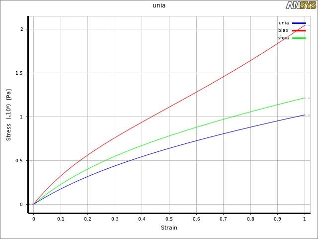

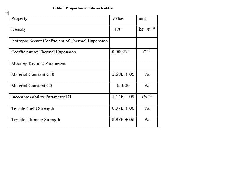

    • jil260
      Here are more details all I have. How did you figure this out? Is there any application or formula?

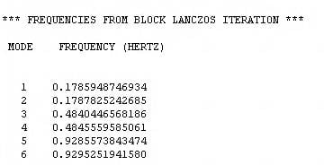

      The slope of the blue line is the linear elastic property of Young's Modulus. Estimate the slope at a small strain, like at 0.1 and it would come out to about 1.8 MPa.  The value I used in the first model was 80 MPa so the natural frequency will drop significantly. The first natural frequency is now 0.18 Hz and mode 2 is 0.48 Hz.

      May I ask why the frequencies of 1 and 2 (3-4,5-6) are so close? As you mentioned before, mode 2 is 0.48Hz, so it's the third one instead of the second listed above?
      A circular beam along the Z axis can vibrate sideways in the X direction, or it can vibrate sideways in the Y direction.  ANSYS finds both of those solutions. The exact solution is that it can vibrate sideways in any direction as mode 1.  The same goes for the higher modes, ANSYS finds the X and the Y vibrations which have the same modal frequency. You could call that pair mode 2 and the following pair mode 3, even though ANSYS is up to 6 modes.
