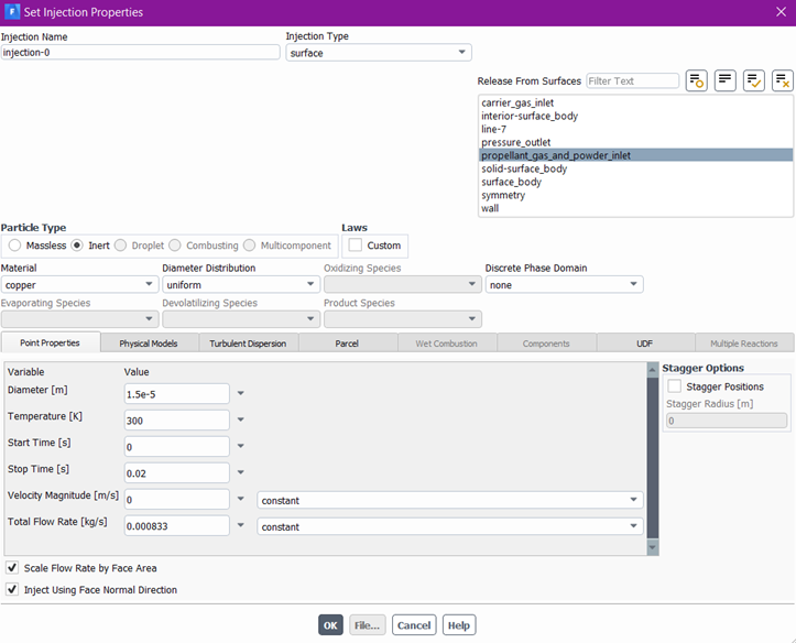

SubscriberI am performing DPM simulation of a cold spray process. Solid particles are being injected into a stream of gas. I have created an animation of the particle tracks. The behaviour of the particles is exactly the same as the gas. The velocities are same. However the velocity of the particles should be around 63% of the maximum gas velocity. Kindly tell me which option to select in the Discrete Phase Modelling tab or injections tab that will make the gas interact with the solid particles.
Interaction with Continuous Phase and Unsteady Particle tracking options are turned on.

SubscriberThat is proved in literature that the particle velocity is 63% of gas velocity. I am trying to validate it. I solved the earlier problem. Now the problem i am facing is that particle velocity is coming out to be around 45 to 50% of gas velocity. I think i am doing something wrong. The velocity should be greater than that and equal to 63% of gas velocity.
No Physical Model is selected in the following tab.
In the following tab, spherical model is selected by default in Physical models. Discrete Random Walk is turned on and Random Eddy lifetime is turned off in Turbulent Dispersion.

Ansys EmployeeInteraction with continuous phase and turbulent diffusion are the only required ingredients here if and only if the flow is far from being densely packed.
