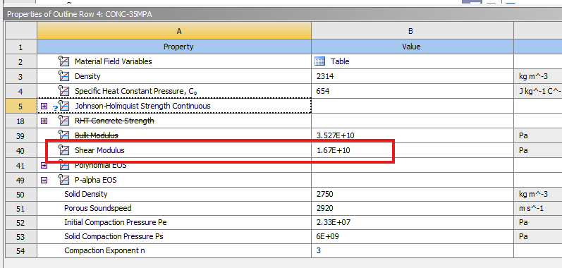

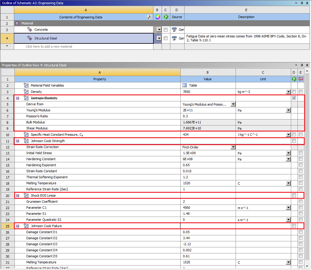

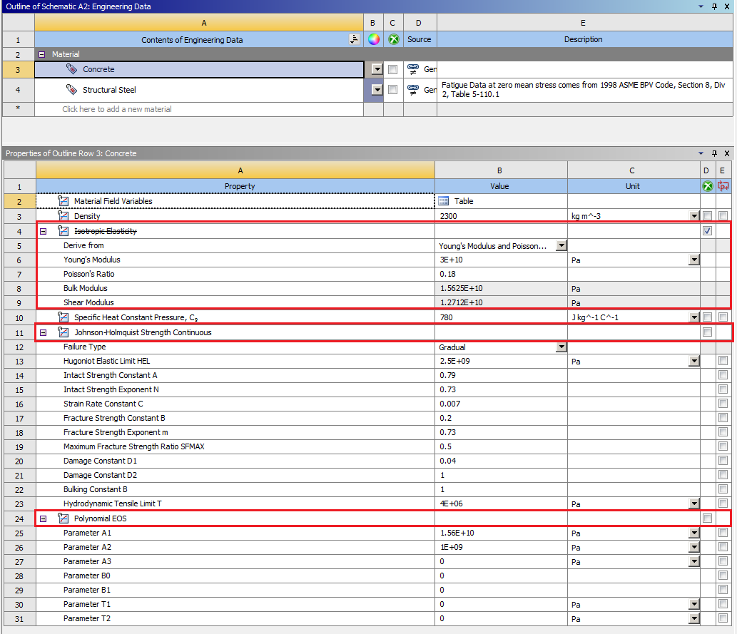

      I used the default concrete Engineering data offered by Workbench, then added Polynomial EOS and J H strength. Both shear modulus and bulk modulus are frozen in the isotropic elasticity properties. After I had finished setup, I tried to run the solution, but I received an error message, "Concrete must have shear modulus defined," and it terminated.
      Could you please help me figure out this problem?
    • Chris Quan

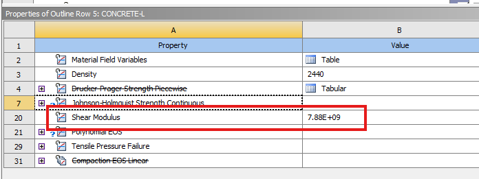

      Can you make it clear about what material you have retrieved from the Explicit Material library and how did you add the Polynomial EOS and JH Strength to the material?
      I tried it. I was able to see Shear Modulus defined. See pictures below.

      I used the Engineering material data for both concrete and steel as shown in the attachments.

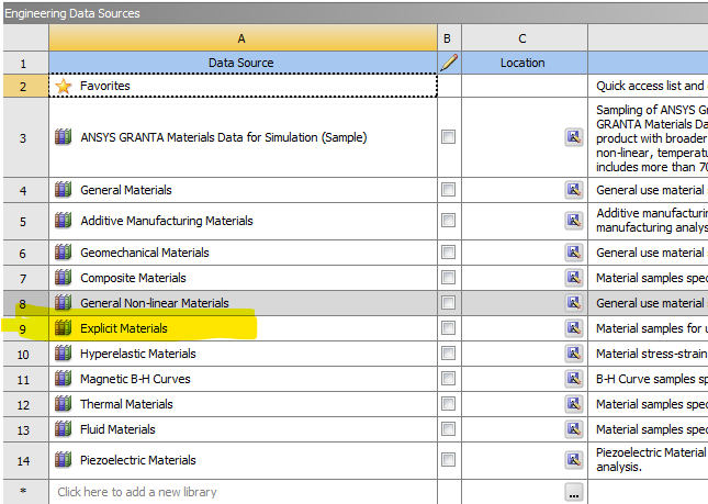

      The materials in the General Materials library are typically used with the MAPDL solver.
      For the Explicit Dynamics system, we generally recommend selecting materials from the Explicit Materials library, as these are specifically tailored for Explicit Dynamics analyses. (See the screenshot below.)
      You should only use materials from the General Materials library if you cannot find a suitable option in the Explicit Materials library.
      Please follow the screen snapshot in my first response to retrieve the concrete materials from the Explicit Material library and then modify it for your use.
