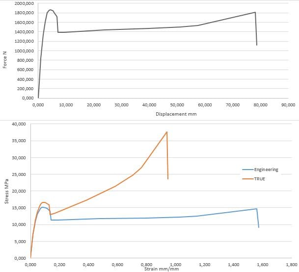

I have the experimental date of PC material (plastic), from tensile test I got force-displacement, when It converted in the engineering and true stress, I got that the true stress falls. As we know that in Ansys can not be input decreasing stress, can anyone help me with this problem.
First I think that this true stress strain use for the pipe specimen with diameter of 12,5mm, Where I need the max force which pipe can endure during tensile test. And I got that is about 1800N as in the below pic.
Second I think to use true stress strain for drop test, where need to determine when the plate (500x500x15) will break (when strain is about 1mm/mm) if on it drops the sphere of 0,5kg.  The plate is of the same material as the pipe, PC.

SubscriberNecking of the specimen occurs during the test. Once necking begins, the displacements beyond the point at which necking began cannot be used to create Stress-Strain material data because the assumptions of uniform plasticity are invalid and the conversion of Engineering Stress and Engineering Strain to True Stress and True Strain becomes invalid.

Yes, the necking occurred during the test.

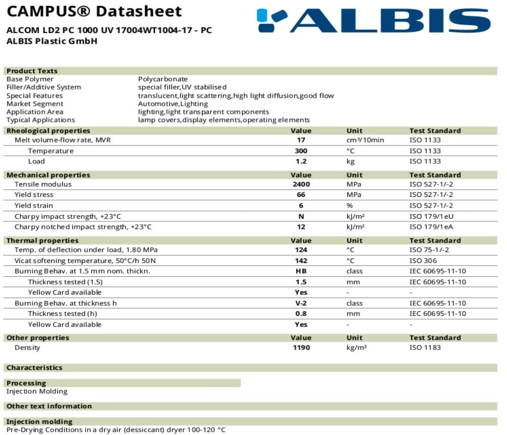

Thanks for the information. Which the parameters from material needed to be used for determination when the part will totally separation. I attached data sheet of the one another material which has all parameters which some of them maybe can be used for drop test for determination separation. I sent this as example not the parameter of PC.
Did You have any suggestion how to simulation drop test with this material, where I need to determine the dimension of ball steal which will cause totally separation of the plate (500x500x15).
I can not tell that when occur the necking that the construction will the totally separation, only in that point is the necking?

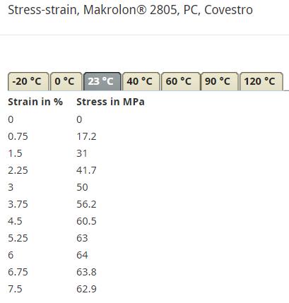

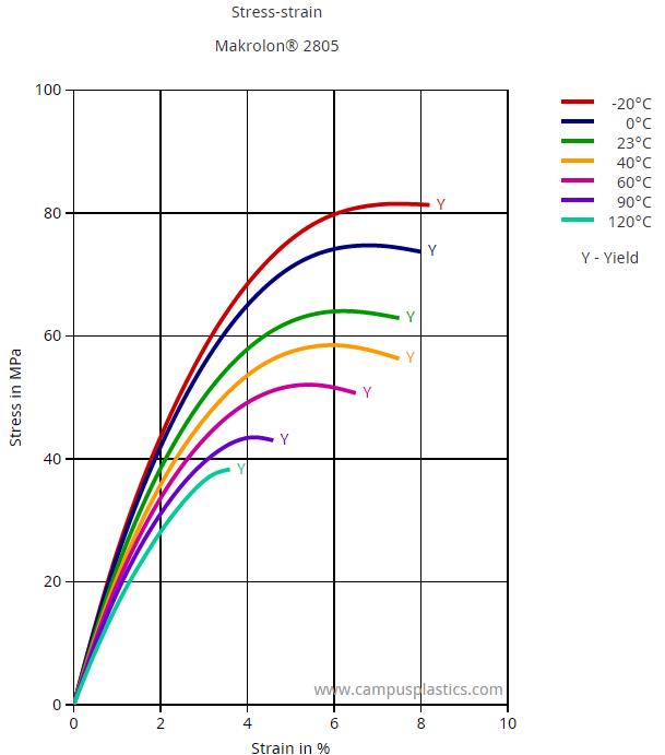

SubscriberLook for another PC on Campus Plastics that has a Stress-Strain diagram.
Click on Control Points to get the Excel numerical data.
Convert this Engineering Stress-Strain data to True Stress-True Strain for use in a Multilinear Plasticity material model.

 From the above stress-strain diagram for temperature 23C, at stress 62.9 and strain 7.5%, I can guess that will occur the totally separation of the part during drop test, or ?

SubscriberThe above plastic stress-strain curve is up to the point of Yielding. Perhaps this is where the necking begins.

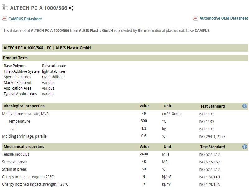

Here is another plastic that shows the strain at break is 30%, but this plastic doesn't have a Stress-Strain diagram.
Another property of plastic is strain rate sensitivity, so the elongation at break might be function of strain rate. In other words if the material is stretched at 0.1 mm/sec it might get to 30% strain when it fractures, but if the material is stretched at 100 mm/sec, it might only get to 5% strain when it fractures.
