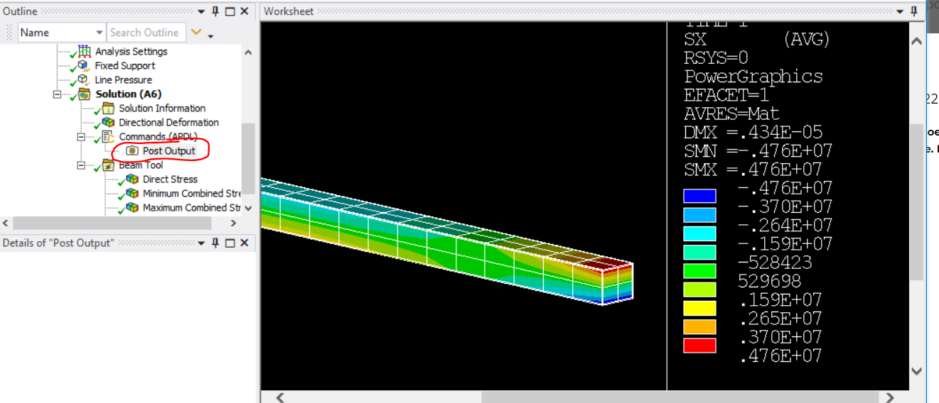

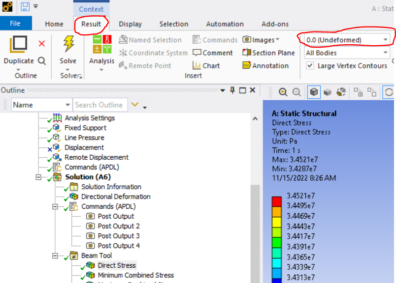

      I tested adjusting number of cells used in the beam cross section with the SECDATA command in a command object under the line body and, like you see improper results displays. I think Mechanical expects 2 X 2 cell beam cross section, and it isn't written in such a way as to accomodate other possibilities.  One thing that might help is to set the display displacement scaling to zero:

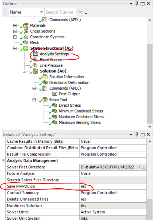

      You could also try a post processing command object - have MAPDL solver create static images of the beam results. First, before solving, request that the MAPDL db file be saved:
      Next, insert a command object under the solution branch such as this one:
      finish
      /clear
      resume
      /view,1,3,1,3
      /graphics,power
      /eshape,1
      /post1
      set,last
      /show,png
      plns,s,x
      /show,close
      You can access the image by clicking on "Post Output" under the command object in the tree:
      Note that SX is the stress in the direction of the axis of the element (direct + bending stress) - even if the beam axis is not aligned with the global x axis. The appearance of the displayed stress distribution will be much like that you'd see if you were using solid elements.

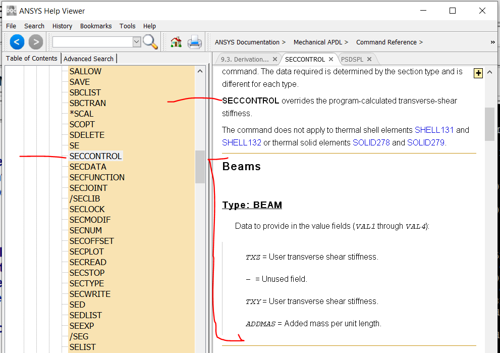

      Related to (though admittedly not directly addressing)  your question about shear stress output... one way to specify transverse shear stiffness is with the SECCONTROL command:
      I hope this helps,

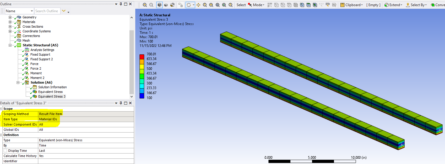

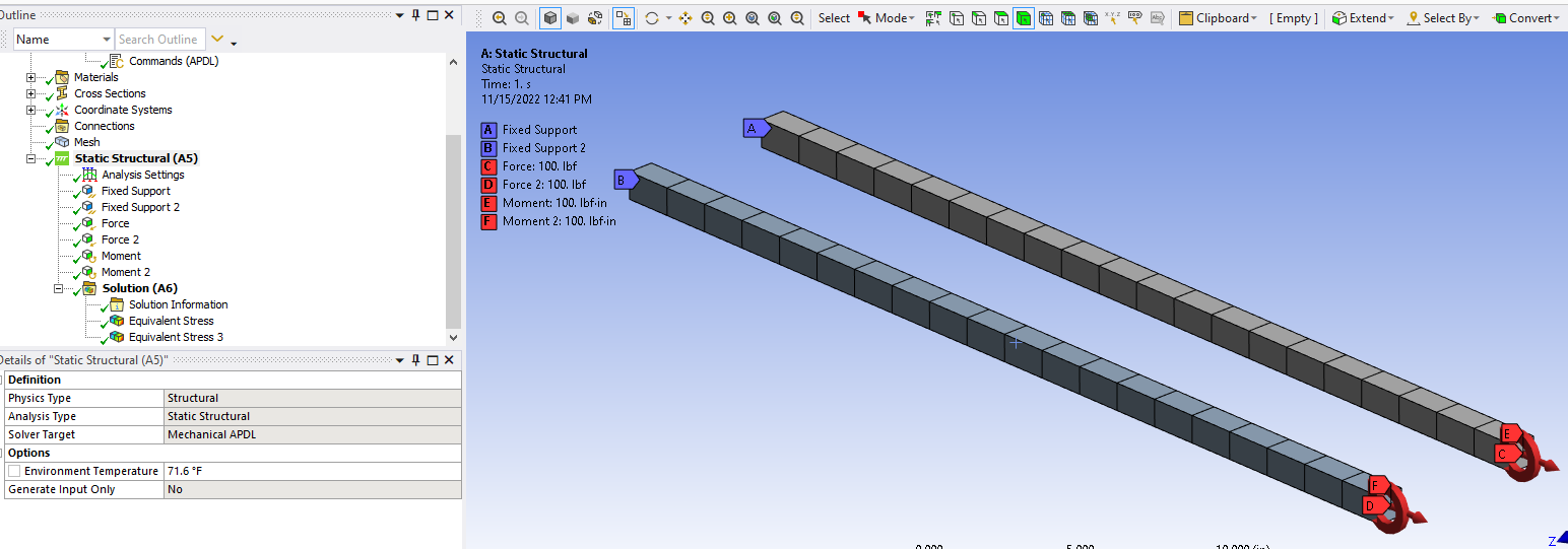

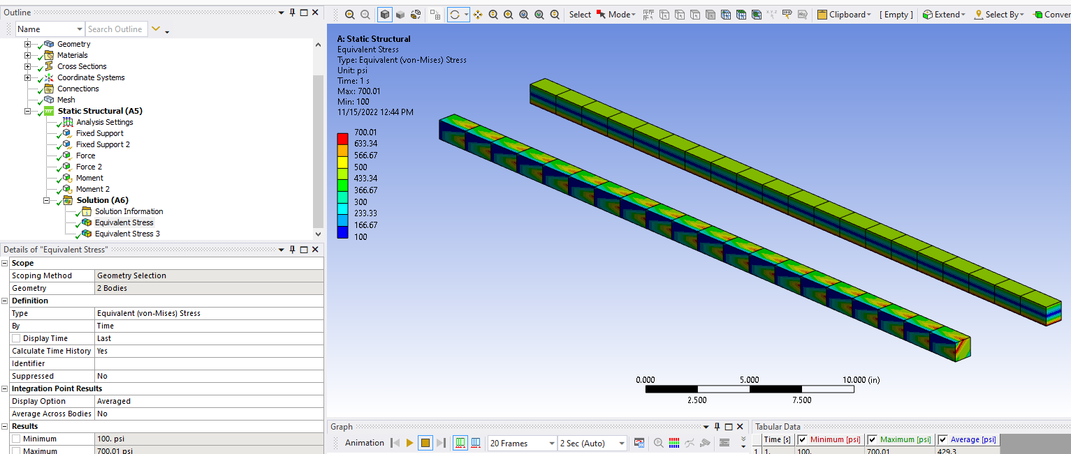

      What is happening is that WB Mechanical is not 'aware' of what a Commands Object is doing with respect to the FEM.  Mechanical is writing out the FEM based on its model tree, but the Commands Object is changing the FEM but only when the model is being solved.  So you can imagine when Mechanical is post-processing beams from their sections nodes (in order to plot seqv) the numbering on the result file does not match what Mechanical expects.
      Let's say the model was two cantilever beams 36 inches long and 1x1 inch square cross section aligned with global X.  The default mesh is kept on beam one, so it has 4 section "elements" and 9 nodes.  Whereas beam two has 6x6 section mesh so 49 section nodes.
      Fixed one end of the beams and load the other with 100lb axial and 250 in-lb moment about global z.

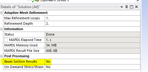

      Change to post process beam section results:
      And post process SEQV
      We can see that the beam in the upper right is correct (default section mesh) and the one in the lower left is not (CO to change section mesh).  This is expected as Mechanical thinks beam 2 has 9 section nodes whereas it has 49.  Instead post-process by Material ID so it's a more direct read/presentation of the results:
      And the results are as expected.

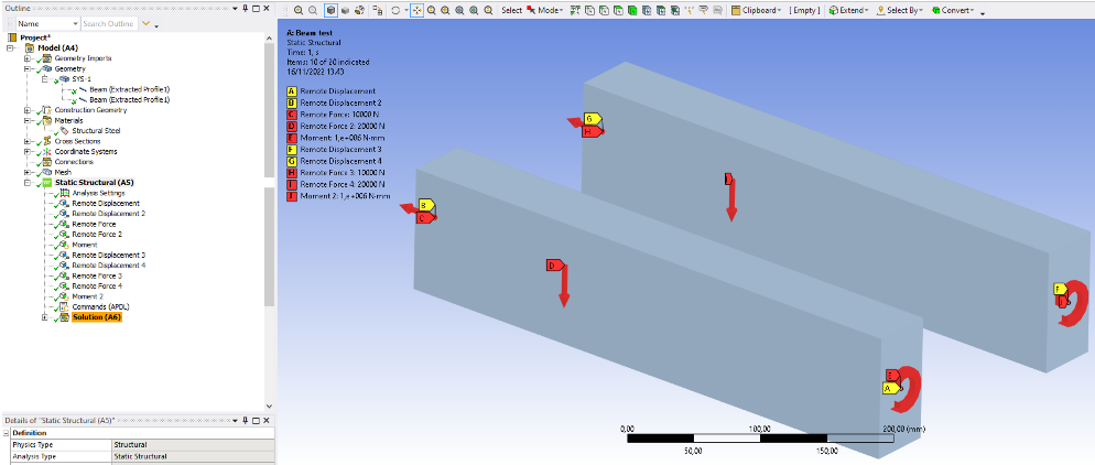

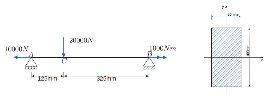

      Here was the simple problem that I used for this test:

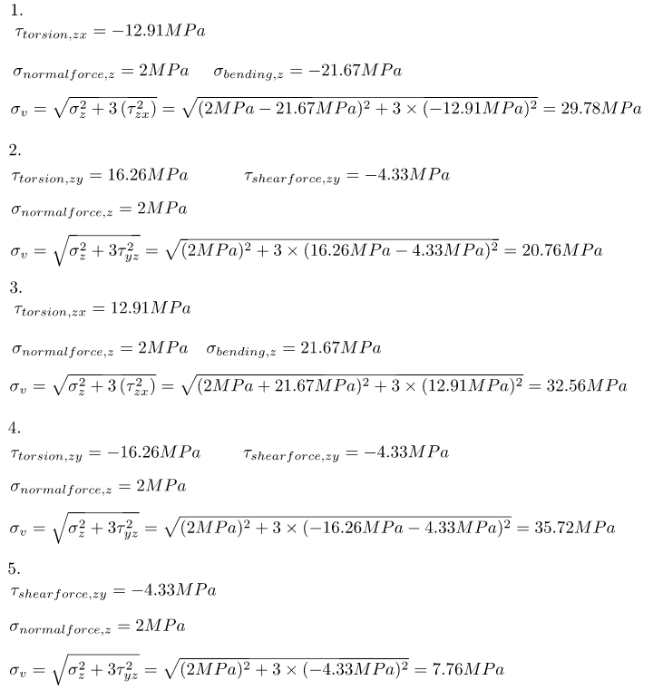

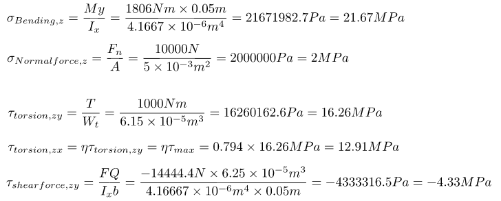

      Hand calculated stresses at point C:

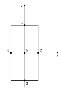

      Hand calculated beam’s cross section’s von Mises stresses at point C at cross section’s 5 different locations:
      Here are the boudandary conditions in Ansys:

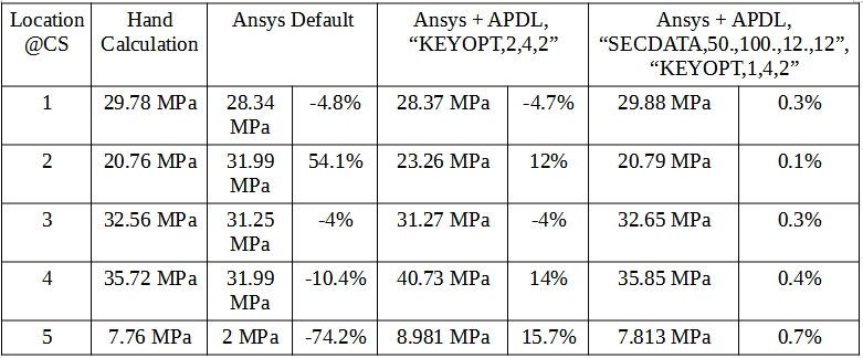

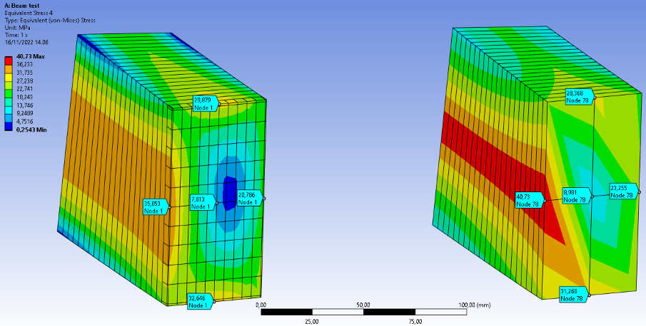

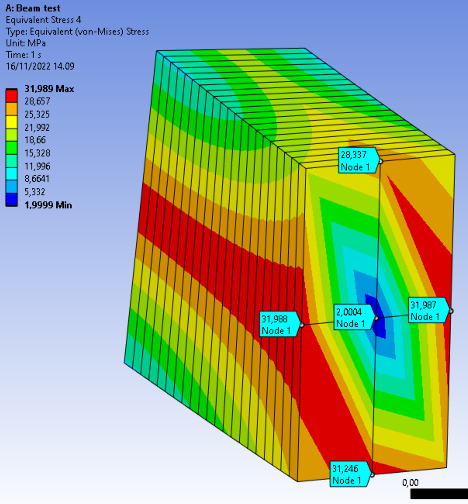

      Here are the von Mises stress results at point C with default Ansys Mechanical’s settings for BEAM189 without any APDL command object:

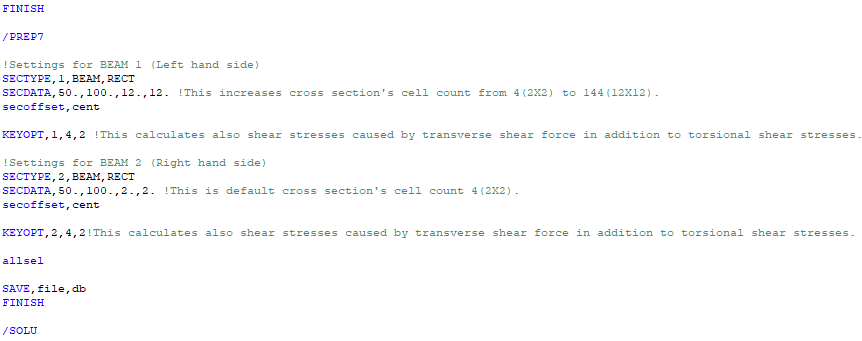

      Here are the von Mises stress results at point C with APDL command object for BEAM189. Beam 1 is the left hand side beam and Beam 2 is the right hand side beam:
      So we can see from the left hand side beam that it was necessary to add this APDL command object to achieve more accurate results by increasing cells in cross section and taking in account transverse shear stresses caused by shear force in addition to torsional shear stresses.
      Here is a summary for the von Mises stress results and Mechanical’s results difference to hand calculation:
      However post-processing results by Material ID naturally removes ability to post-process results by vertex, which could be useful in some scenarios. My workaround was to create section planes to post-process cross sections at certain locations, but it might be time consuming process in large assemblies.
