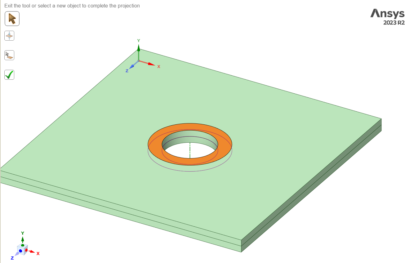

      If it is one time operation, you can use project tool to project the solid imprints on the midsurface:
      -Aniket
      • jeon hyeon min
        Thank you Aniket!
        But the problem is, there are so many plates around those bolts. So if I use Projection, Bolt's projected areas are imprinted to plates that I don't want...
        Is there any other way?
