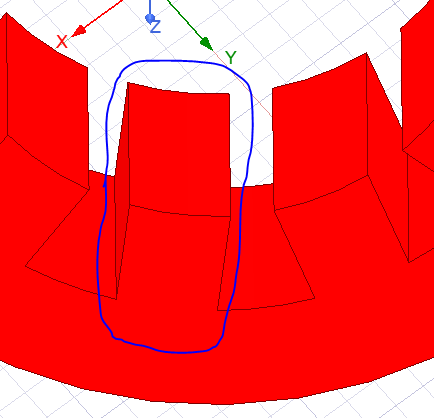

You can draw 3d shapes that intersect with the unwanted portion and then use the subtract boolean operation to remove those portions.
OR, you can draw a cube with the teeth dimension and a cylinder with the inner diameter of the stator and then use subtract operation to get that shape.
