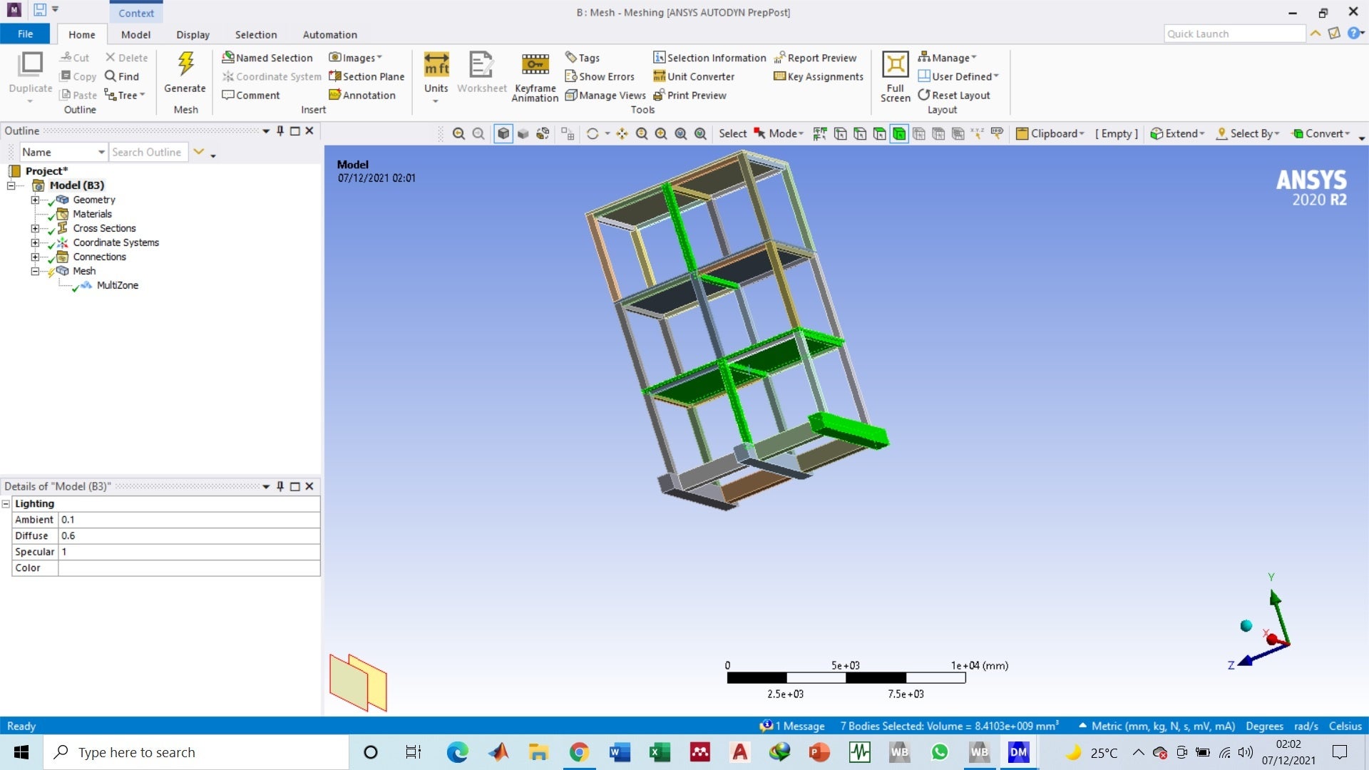

SubscriberHello every one. I am trying to figure it out how to find the type of element one is using? I comparing two cases which are qqite confusing however, I am using same setting to generate mesh but when I look into solver out put in one case it is showing the element type are SOLID 185 and in other case its showing SOLID 285. Below the mesh setting along with snap from solver out put are also show,

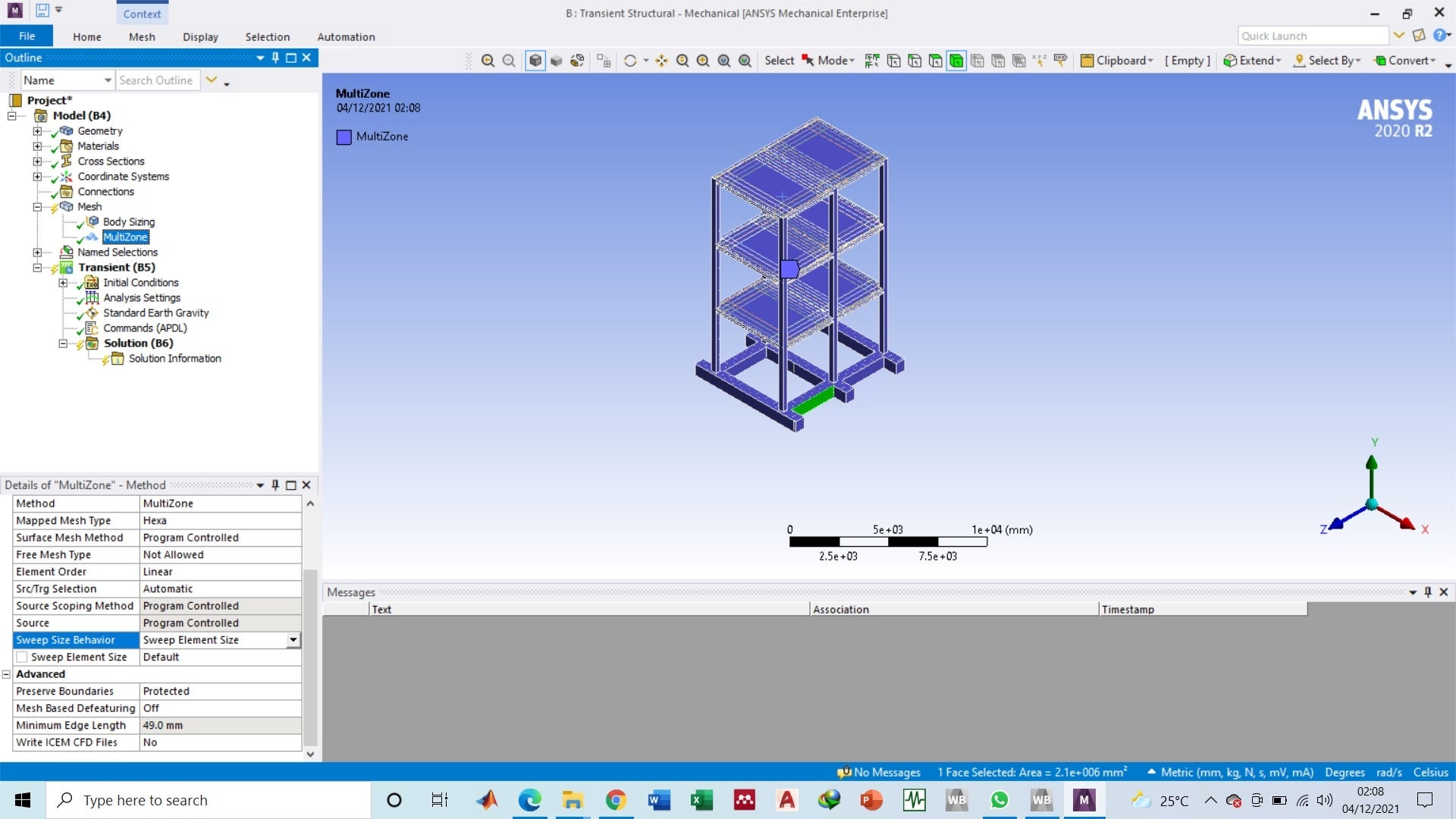

SubscriberI am setting the elment order to linear always. To make sure a pure Hexa mesh I am using a method-multi-zone for concrete body but always my meshing fails with two error messages.
1)MultiZone blocking decomposition failed.
2)A mesh could not be generated using the current meshing options and settings.
You can also see the setting of my mesh in the attached images.
Any suggestions on this issue?

SubscriberYou can either take 2 seconds to change the element order to quadratic but pay for longer solve times.
Or you can take 2 or more hours in SpaceClaim slicing the solids that won't hex mesh into six-sided solid bodies and using the Share button to connect the mesh.
Why do you always set the element order to linear?

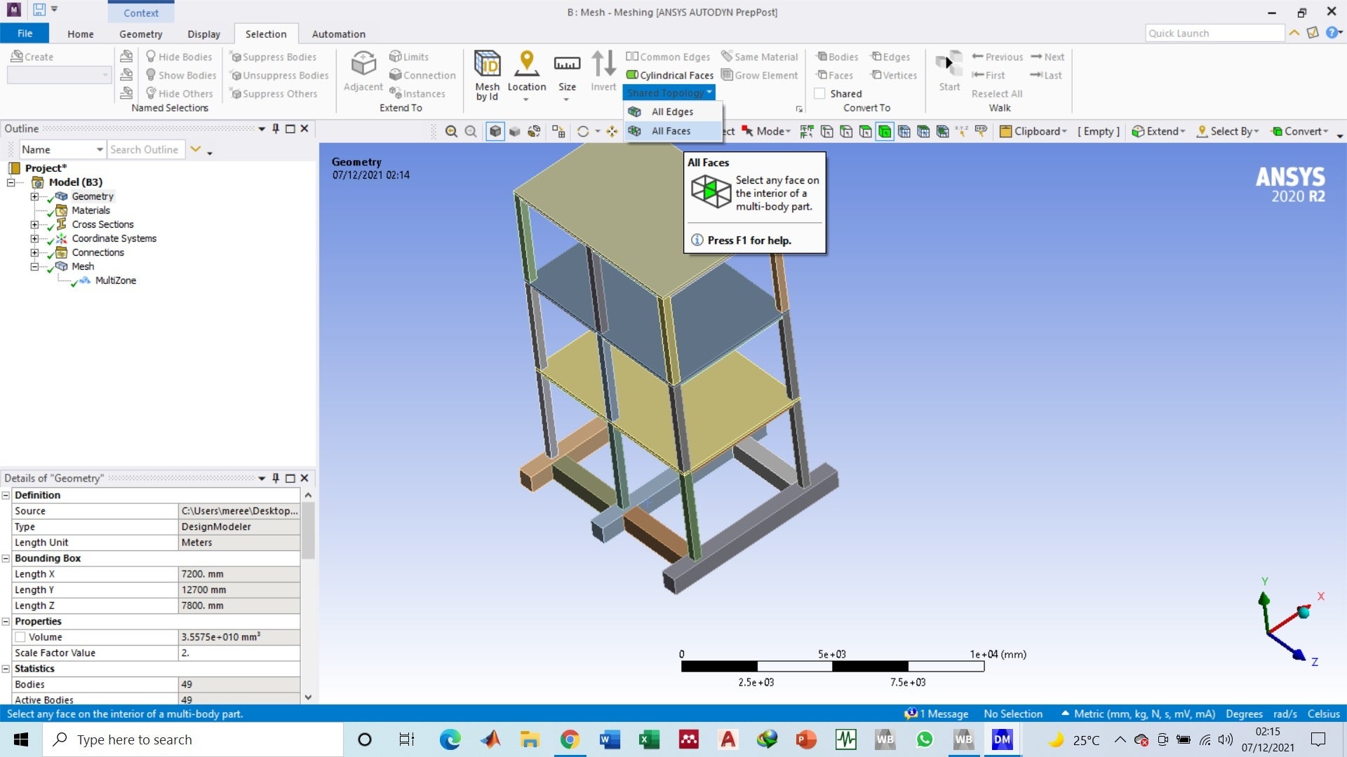

SubscriberI am trying to slice my geometry and Have a little confusion, When I slice my frame all the elements will become separate, then does the assumption of bonded connection works well for concrete?
December 6, 2021 at 4:59 pmpeteroznewman
SubscriberMove a body into its own Component. Open the Component and do all the slicing to get six-sided bodies. On the Workbench tab, click the Share button. Now all the bodies in that component will be meshed across the slices faces and held together without Bonded Contact.

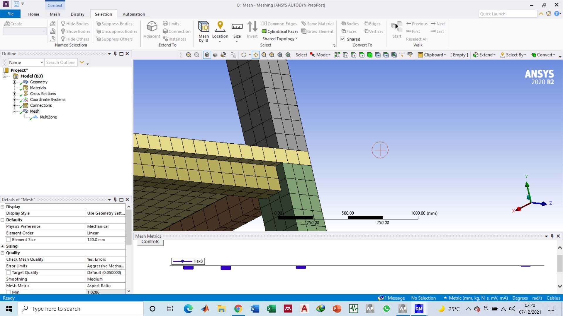

SubscriberWhat does it mean to move the body into its own component? I Have a single body which I already sliced in design modeler , separated all beams, colms and slabs into single 6 sided components as shown in figure, Now I am not facing any problem with Hexa mesh.
I also checked the shared option but looked like at joints nodes are not shared.
December 6, 2021 at 7:40 pmpeteroznewman
SubscriberComponent is a SpaceClaim term. DesignModeler calls it a Part. In Design Modeler, you have to put all the bodies into the same Part to get the Shared Topology to work. You do that with Form New Part after selecting all the bodies.

SubscriberThis way isnt working actually, When I try to add a method to generate a Hexa mesh with turned on the shared or topology option it is again taking the structure as it was before and i got the error that multizone blocking Decomposition.

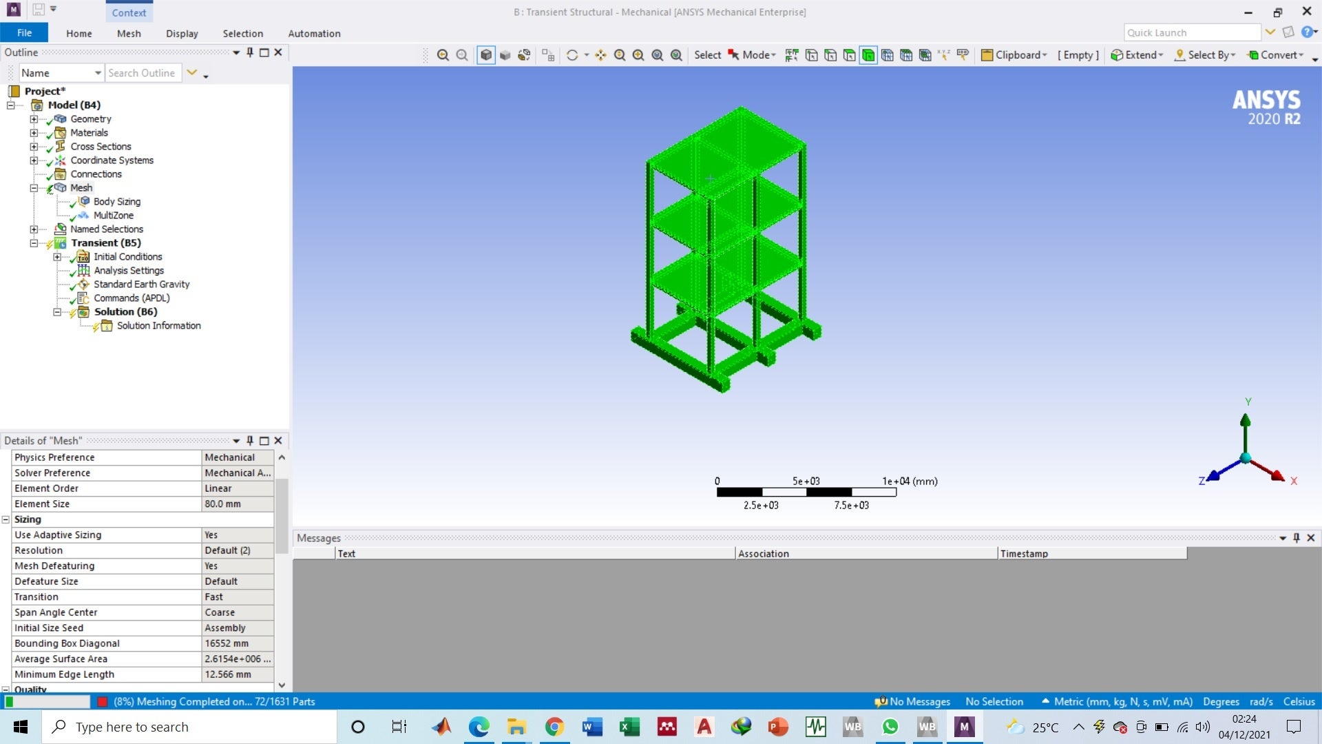

SubscriberWhen you have successfully sliced the solid bodies down to six-sided blocks, you don't use Multizone, you use Sweep. If you do nothing, it will choose sweep automatically.
In Mechanical, right click on Mesh and Show Sweepable Bodies. Everything should highlight in green.
December 8, 2021 at 6:05 pmBaloch
SubscriberI checked all bodies were sweepable but still I was getting the error of pc running out of usable memory. However, the same approach later works when I further sliced the structure in the areas which were already sweepable and now I am getting the desired mesh. Thanks btw
