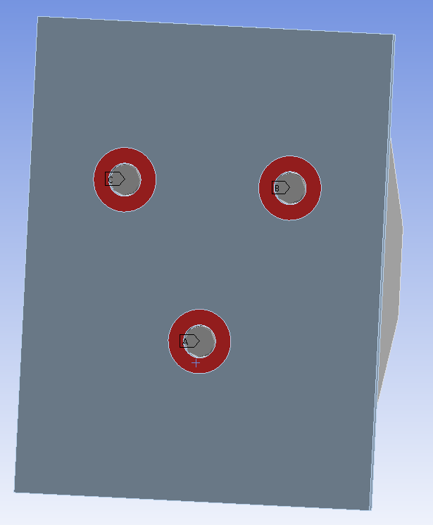

      Hello all,
      I am currently trying to pull the reaction forces from the body-ground bushings that I have on my model. The bushings are tied to the same rigid remote points as beam connectors. As shown below;
      Currently, I am trying to pull data from them using the Joint Probes, but when I attempt to evaluate results it returns "The result data for JFL is not contained in the result file."
      I am currently outputting everything and saving the MAPDL db, and have also tried removing the beam connection attached to the remote point.
      What should I do to be able to pull the reaction forces from these bushings? Alternatively, is there a way to attach a remote displacement to the "ground" side of the body-ground bushing, so that I may use a normal reaction force probe?

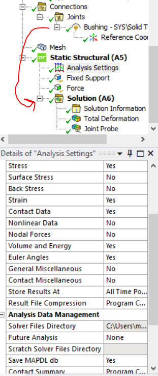

    • Manish Dubey
      You can drag and drop the bushing joints in the solution branch of tree and then you can retrive the results as shown below.
