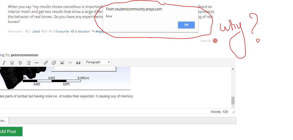

    • deepmech.maurya
      when i am replying you on another question its show above shown error.
      thank you
      The website parses the textbox where we type our post and looks for embedded code that it tries to execute. Unfortunately, some of the text we type looks like code because it has a keyword, or parenthesis or equal signs, but it's not intended to be code so it does not compute and generates an error.
      I now select all the text and copy it to the clipboard before I hit Add Post, because sometimes all the text is lost and a blank post is created.
