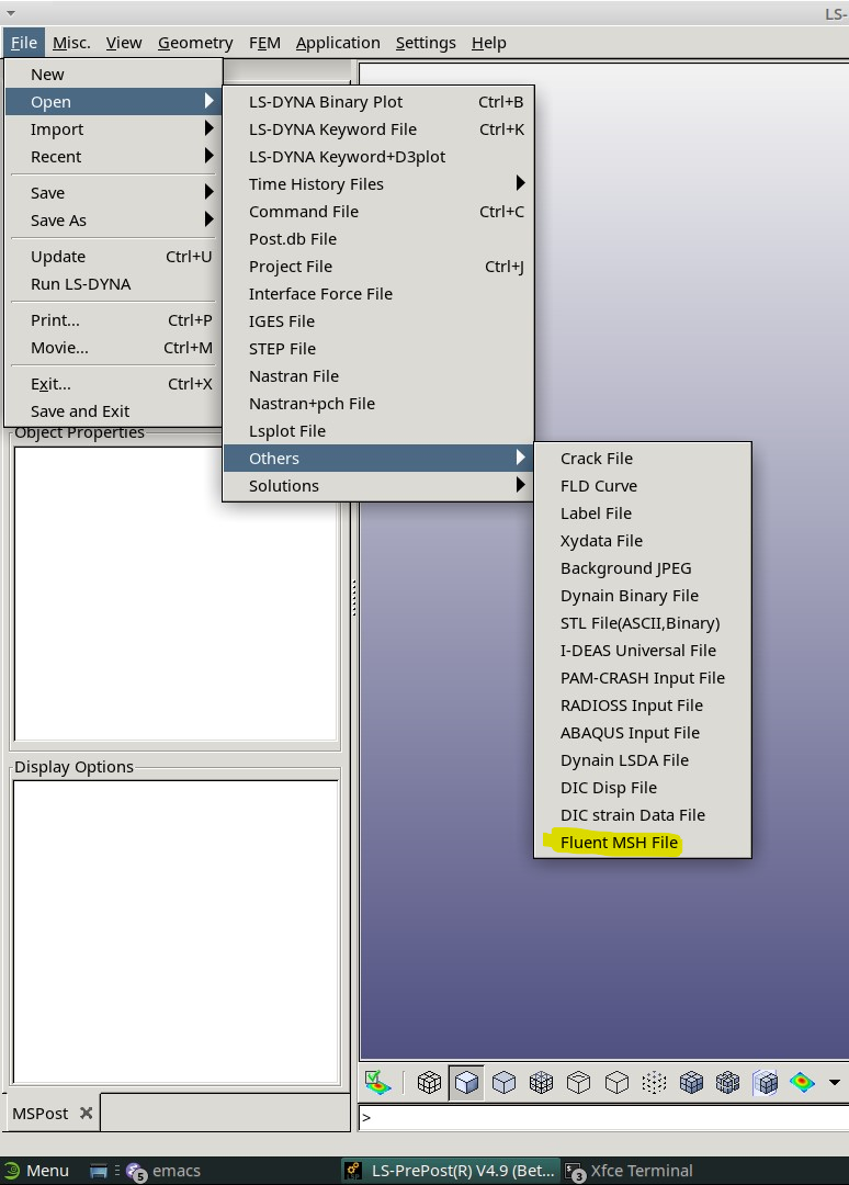

      Alternatively, you can use the new tool in LSPP 4.9 to import ASCII "msh" meshes created in Fluent meshing (see image below). It is important that the "msh" file is in ASCII format.
