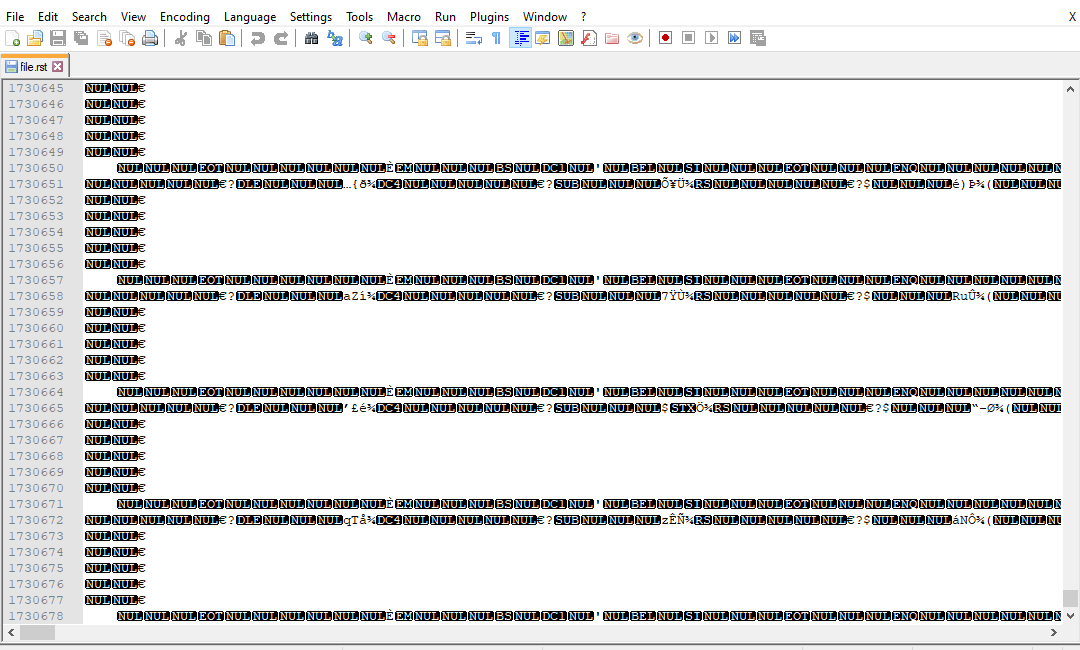

      Asking this question just for clarification. The results are stored in file.rst ?nI tried opening such file of another project which is only 100 MB. But it looks like the file is encoded. nn
      I thought you were using the code provided. Don't open the .rst file, that is binary.nGo to the mechanical folder where you work and find force_XX.txt as described in JJ_thompson's post.n
