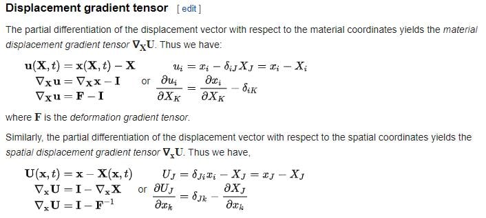

      Here is the definition of Engineering Strain. It is a change in length divided by the original length.
      Strain at a point is just this definition as the original length approaches zero.
      When you say deformation gradient, do you mean what is shown below taken from Wikipedia?
      Please explain why you need the deformation gradient?  What is it for?  How will you use it?

      I found that I have misunderstood the conception of "deformation gradient".
      Base on the formulas, I believe you are right,  strain is the same as deformation gradient.
      My major used to be image processing and I thought the gradient defined as below (from Wikipedia):
      The gradient of image is calculated based on the adjacent pixels within one image, so I thought "deformation gradient" share the similar definition.
      So I just simply extend the conception of "gradient of image" into 3D condition (Which is now proved to be wrong). Maybe I should call it "differential deformation" in 3D finite element method application.

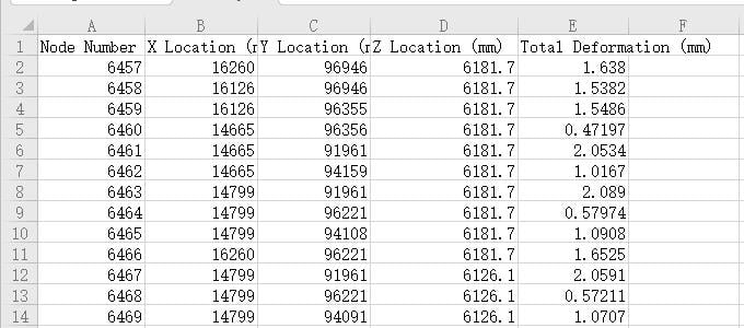

            I've finished to calculated this "differential deformation" in MATLAB in text format as below:
            But I don‘t know how to import this kind of data back to ANSYS WORKBENCH.
            Could please give me some advice about how to achieve it ?
            Or do you know how to calculate this "differential deformation" in ANSYS?
