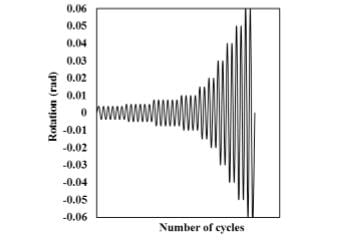

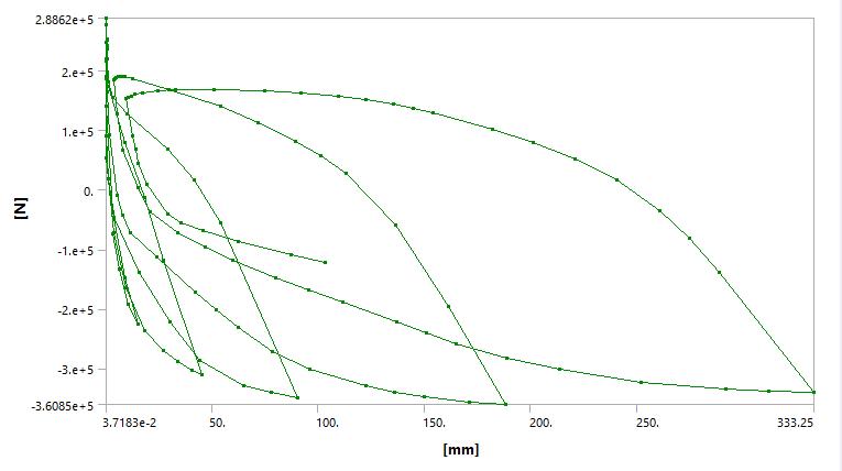

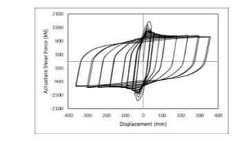

SubscriberGood morning guys , on a steel frame subjected to a linear increasing load applied as a cyclic loading i applied the loading protocol shown below to get the force -displacement diagram shown on the curve down , i used a tabular data but the results doesn't match with the disered ones . any help here ! is it the correct methode using and do i have to use some commands to get a correct curve ?Â
thanks in advance .Â

SubscriberDid you use Directional Deformation? That goes positive and negative.
Because Total Deformation is always positive.
February 19, 2020 at 3:23 pm
hamzaDZ13
Subscriberyes i used the directional deformation it's gives postive and negative values as shown above but not as the disered curve .
February 19, 2020 at 7:56 pm
peteroznewman
SubscriberI don't see any negative values in the X axis of your plot.
February 19, 2020 at 10:47 pm
hamzaDZ13

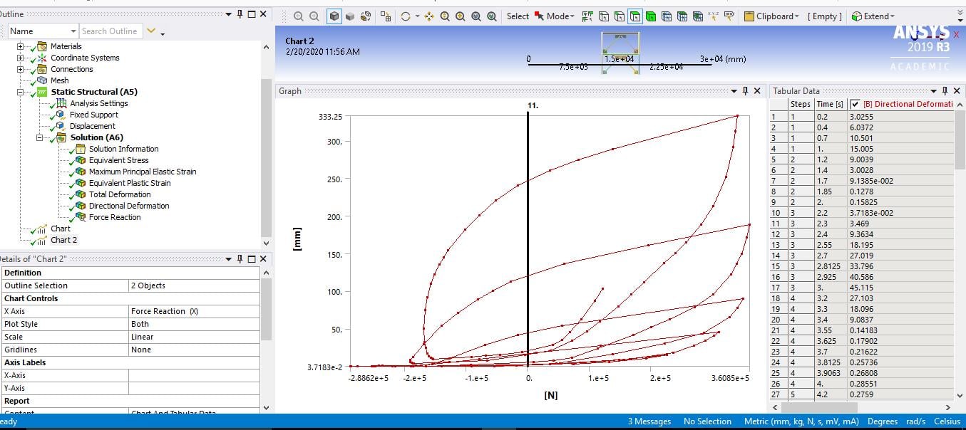

Subscriberyes exactly there is no negative values on the X axis , the displacements given on the X direction at the top of the higher comumn , so wht you think i did missing or what's your suggestions to make it correct ? do i need to specify a deformation of a point from the frame not all of it ?Â
February 20, 2020 at 1:36 am
peteroznewman
SubscriberIn the first image, I see you have applied +/- displacement to an edge on the top right corner of the structure.
Where is the Directional Deformation scoped to?
