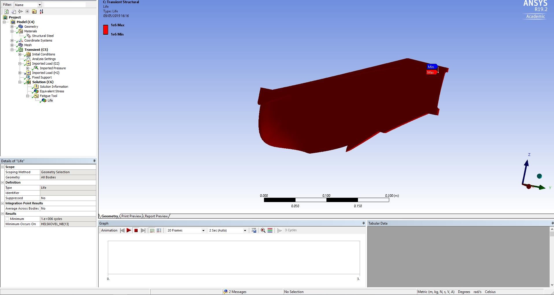

      I made a small transient Structural Analysis of a Turbine Blade. But I am unable to calculate the "Life" in the Fatigue Tool because i do not choose "history Data"? It just shows the same lifespan over the whole shovel even thoghEquivalent Stress clearly shows weak spots where it should fail earlier.
      I read in other Post about how to load history Data but not quite understand why i cannot use my Solution?
      Same goes for the Rainflow, the reason i made the transient analysis is to calculate the loading cycles for that varying load, so why i cannot use my solution??
      Thank you for any help
    • Naveed
      Dear Gaddsch,
      Can u attach high resolution screenshot of your details view? What is the Display Time in fatigue tool? For example, if it is 1s, software will see stress at 1s and calculate the life based on that value of the stress.
    • Gaddsch
      Hello Naveed, thank you for your reply. Your question helped me as well, we might probably be hanging at the same thing.
      "Equivalent Stress not beeing a Load but  a result" opened my eyes. I always missunderstood that completely.
      Could you link me the fatigue tool handbook you were referring in your other post?
      I attached you the 2 screenshots and hipe they are detailed enough. One in Exported Pressure and one of "Equivalent Stress" in Solution
      So you mean, i need to deactivate "Display Time somehow?" I just put it on "P" and try what will change. If i find out anything else, i ll let you know

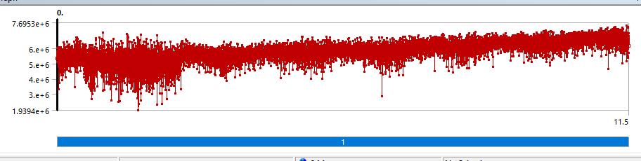

      3) get History Data out of Meassured Signal? to do step 4: Measured signal is pressure fluctuation over time and looks like this:
      4) Imply Ansys Fatigue which will use the calculated equivalent Stress and modulate with History Data, uses rainflow to calculate cycles and sums inflicted damage out of it
      So step 3 is where i am hanging, (if i understood step 4 correctly out of what you and peter told me so far)
      If i kept that going, the result would be ok for me: All other option is see, to calculate Equivalent Stress in Transient and do fatigue live calculation via S-N by myself. Problem here is, that the solution is way too low (underneath infinite life threshold)

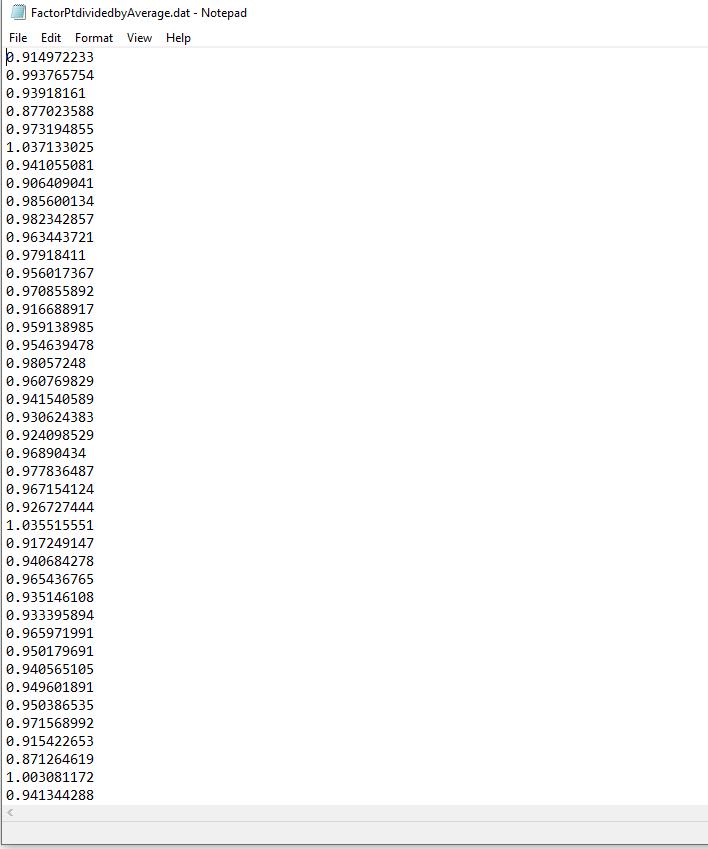

      Edit: Would that work:
      i try to get a ratio of my pressure signal to the equivalent stress.
      So i plan doing few analysis what equivalent Stress is calculated at certain pressure. Out of that i want to have a factor, that transforms me the pressure signal into equivalent stress
      Pressure(t)*Factor=MaxEquivalent Stress(t).
      By doing that, i create the history data, that i implement in mz static structural and calculate a valid life... Does that make sense?
    • Gaddsch
      Allright, no i am really kinda lost here. Any idea why i am unable to put this file into "History Data"
      Did everything as usually and till now it worked fine...
    • Naveed
      Sorry for late reply. First of all, I cant recall which fatigue handbook are u asking about. But I can send some ppts and PDFs, just leave your email here.
      Second, as Legend Peter and JJ concluded about history data and display time, it is now clear that entering the display time will show us the fatigue life at that specific stress on STRESS/TIME graph.
