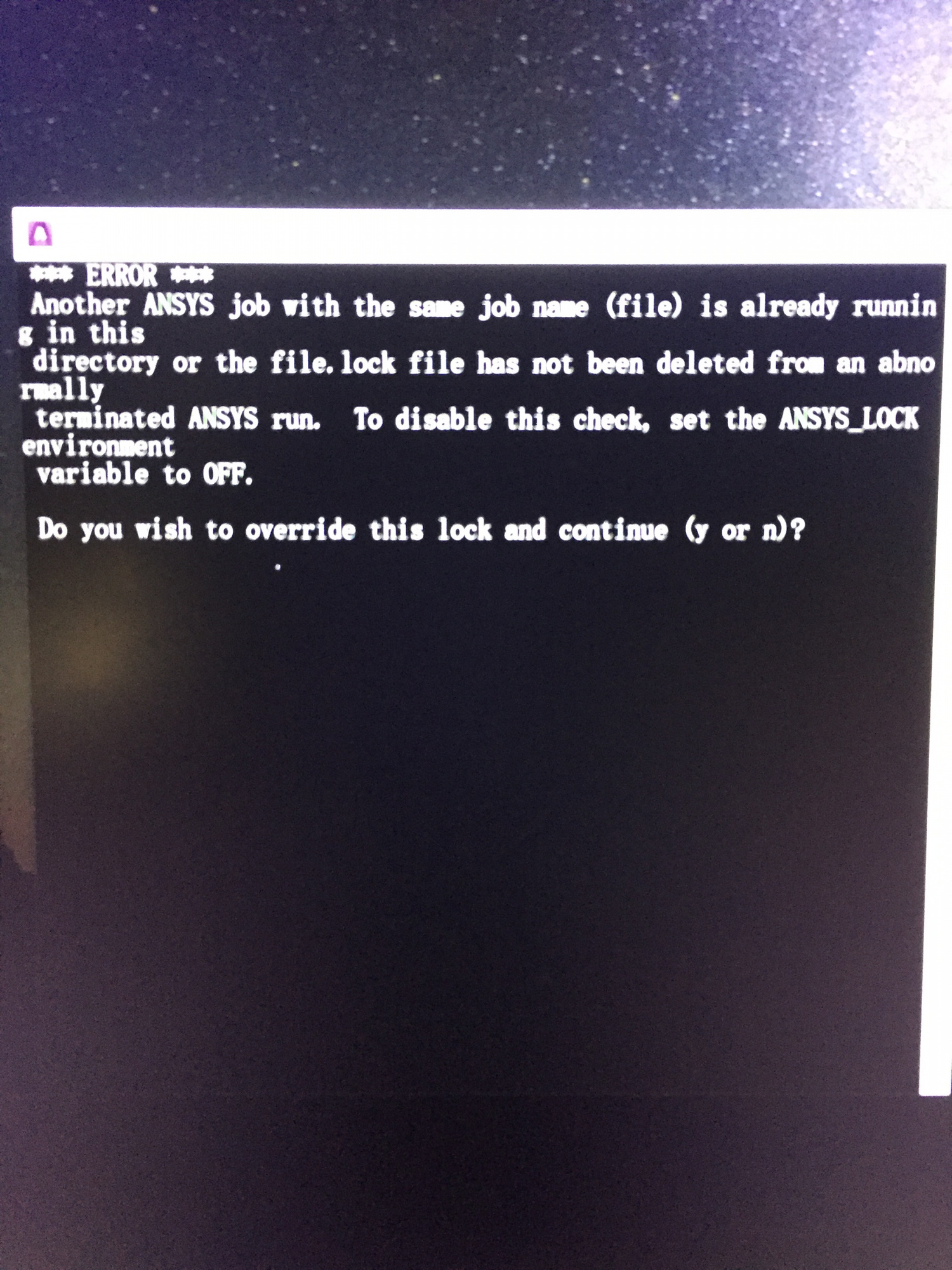

toupi08
SubscriberDecember 7, 2020 at 11:51 amRahul Kumbhar
Ansys EmployeeHi Arrayyou can enter y and press 'Enter' to override the existing files. It should be okay.nViewing 1 reply thread- The topic ‘How to fix this error message its always poped up everytime i open Mechanical APDL 2020 R2.’ is closed to new replies.
