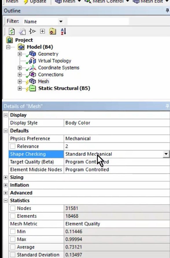

I am trying to follow along with tutorials on how to mesh an object but I have very different meshing details than these videos have and I do not know how to fix it. I mainly want to access the "relevance" tool so I can change my mesh sizing to be finer but I do not have that option within "Defaults" on my meshing details like the videos show. Any ideas?
The tutorial video shows:
October 8, 2021 at 1:03 pmGovindan Nagappan
Ansys EmployeeRelevance option has been removed in the newer version. Tutorial probably shows an older version.
Use "resolution" to make the mesh coarser or finer. See help Resolution (ansys.com)
Or directly specify a mesh size using "element size" field
