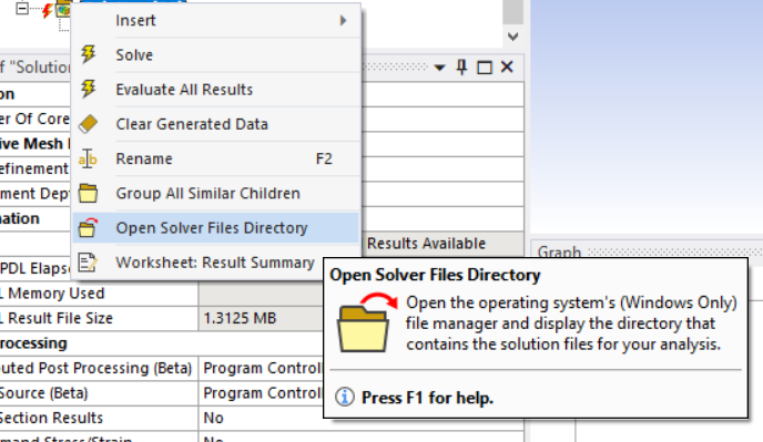

    • Ashish Khemka
      You can open the ds.dat file and check the pilot nodes associated with each joint. Also, all the details while the joint is created is written in the ds.dat file.
      To access the ds.dat file: Right Click on Solution -> Open Solver Files Directory and then you will see the ds.dat file.
      Regards Ashish Khemka
