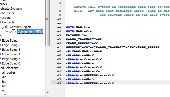

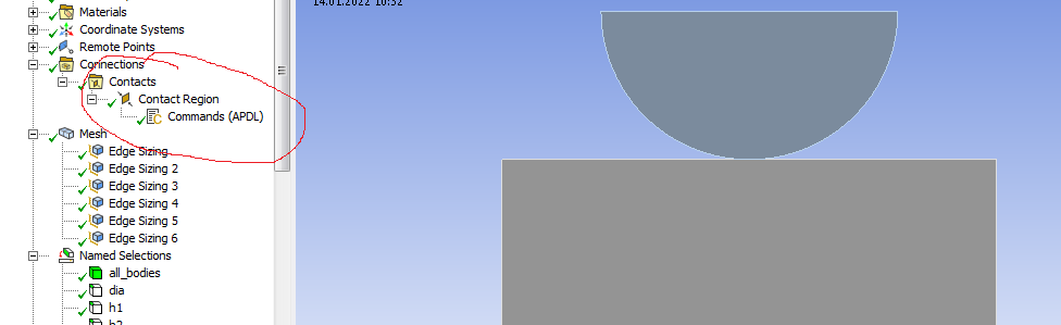

      peteroznewman
      In order to be convincing, please consult the application MECH_TECHDEMO_043, on the ansys help page.
       we were talking about something like that.
      so?
      and it works very well.
      so it's possible!!!
      Costin
      Yes, in my reply to you above on January 13, I said, "Read about Archard Wear in the ANSYS Mechanical APDL Help Manual, Contact Technology Guide, Chapter 14.1 which includes links to the Theory Manual." By that I indicated that simulating wear was possible in the MAPDL solver.
      This discussion is in the Explicit Dynamics category. What you don't understand is that Explicit Dynamics does not use the MAPDL solver. Explicit Dynamics uses the Autodyn solver which does not have the Archard Wear model you show above, that is a MAPDL example.
      You found this link in the Structures category: /forum/discussion/comment/144081#Comment_144081
      There are many links about wear using the MAPDL Archard Wear model, but none of those discussions belong in the Explicit Dynamics category. Try searching Archard Wear using this site's Search feature and you will find more discussions.
