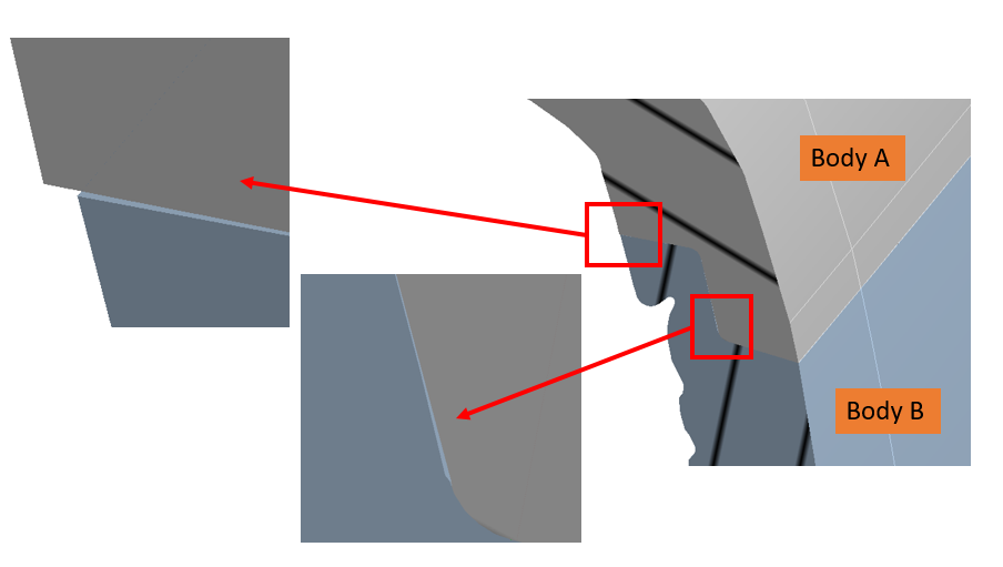

      Hello
      I failed to share the topology between two bodies due to the small gaps as shown below.
      How can I close the gap in Spaceclaim? Thank you in advance!

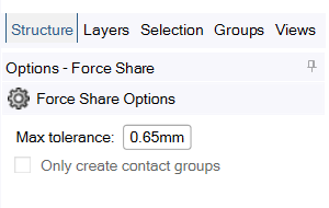

    • Saumadeep Choudhury
      Use "Force Share" in SpaceClaim. Refer to this link - Force Share (ansys.com)
      You can adjust "Max. Tolerance" accordingly (as shown in attached image)
      Regards, Saumadeep
