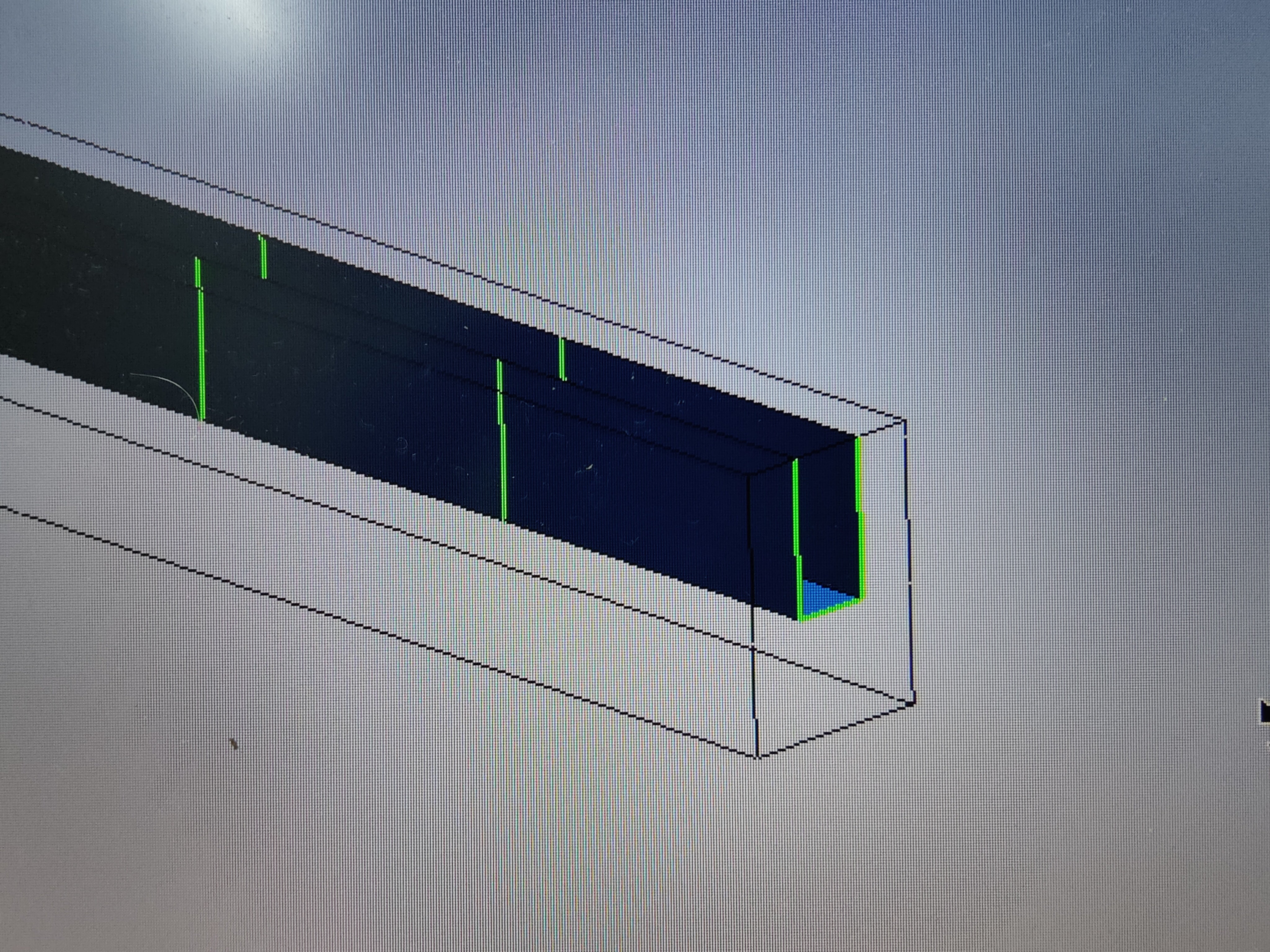

April 29, 2022 at 1:20 amyew511
Is it using the polyline feature as showed in the image above? I wanted to extract the surface temperature of blue shaded region, and I think polyline well suit my needs because i can extract the data at different location which is what I demand. However, when I compare the area weighted average of the entire surface temperature with average temperature of all polyline I created, there is much difference. The area weighted average got 322 K while the average (sum of of all polyline divide by the number of polyline) got 318 K. In this case, it seems that it is not correct to use this method to extract the surface temperature. Any insight how to get proper temperature
April 29, 2022 at 4:30 pmRob
Forum ModeratorThe polyline will be a "line" so it depends on how different the surface temperature is relative to the single line. If you want the values at set positions (length ways) create a serious of isosurfaces of mesh but make sure the blue surface is picked in Fluent when you create the isosurface. That will result in a surface that's the intersection of the blue surface and isosurface: actually it's a line, but Fluent thinks it's a surface, don't ask.

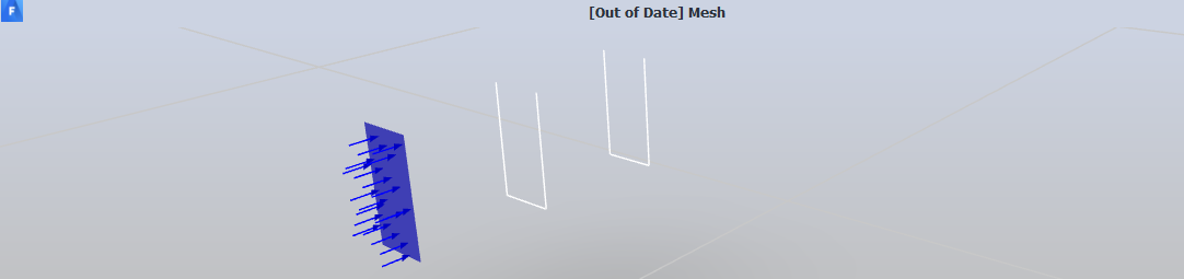

April 30, 2022 at 4:49 amyew511
The white colour is the isosurface line that I have created.
The area weighted average of all these values are 319,71..
But the average weighted average of the blue region (interface liquid) is 322.82.
Here, the average all lines and average of the interface get different value. Hence, is there any way to extract the results such that it would give a nearer reading. It is because this will affect the Nu number calculation because wall temperature is different when using lines from isosurface and from interface liquid (blue region)
May 3, 2022 at 12:52 pmRob
Forum ModeratorThe line is on the surface. The blue face (possibly the inlet) is the whole channel at that position. I would expect them to be different.
May 4, 2022 at 4:11 amyew511
SubscriberHi, the blue interface i mentioned is the previous image published during 29 April
May 4, 2022 at 10:14 amRob
Forum ModeratorThe image on 29th, the blue surface is the wetted wall. On 30th it's an inlet.

May 4, 2022 at 12:35 pmyew511
SubscriberYes, I would like to get local temperature (which is at different location) from the wetted wall as shown in the image on 29th The image on 30th, I show some portion where how i extract the surface temperature which is using the isosurface with intersection method (which results in the white "U" shape at certain distance from the inlet).
First method
I give some distance for example, each 2.5 mm until 10 mm, which is about 40 isosurface to extract the surface temperature of the wetted wall.
Second method
Then, I compared the surface temperature directly taking the area weighted average of the wetted wall.
Currently, i required to use the first method because i need to get surface temperature at different location. But, when compared to second method, the deviation in surface temperature is about 4 Kelvin which is quite large.Hence, I am finding reason why the surface temperature using first method is much different compared to second method
