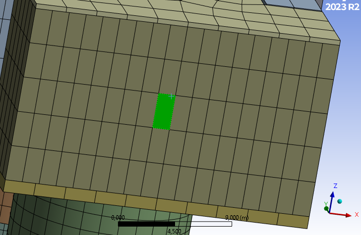

      The final goal is to asign one force to each element face. Obtaining the list of the element faces inside a surface will help to the process. The first trial was to loop through all the elements, but it required a lot of time to compute.

      Do you want to get all elements inside a body, such as a cutout feature inside a body?
      Or do you just want elements or faces attached to a face?
      If it is the latter, you will need the ID of the face, or else place the face in a named selection first, then your script can get the entities in the named selection, which would be the .Entities under the named selection object. To query an ID, select the face, and use ExtAPI.SelectionManager.CurrentSelection.
