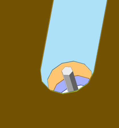

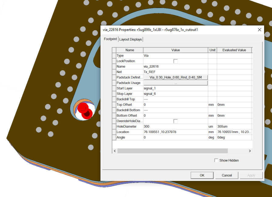

SubscriberI wanted to simulate a through-hole via connecting signal trace in layer-1 to layer-6. The via properties are of right dimension in HFSS layout editor, but when I try to export it to HFSS, the via appears as solid hexagonal pillar. What setting should I change to avoid filling up of the through-hole via.

Thank you for reaching out to Ansys. Right click on Setup that you did the export to HFSS, find the Vias section in the Advanced Tab, change number of side for the vias.Â
