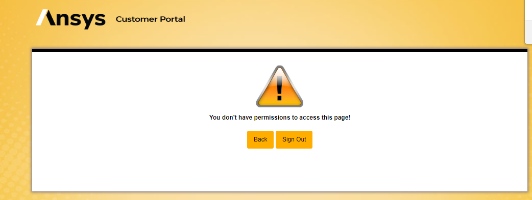

      • yuriporto
        Hi Aniket, I can't access your link. Still works?
