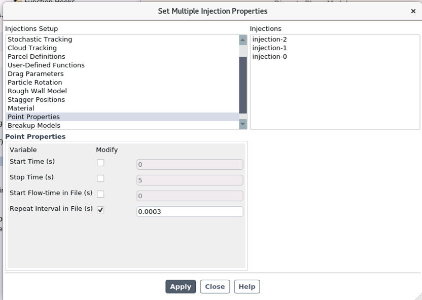

                     Repeat Interval in File: 1e-6 (so that a new particle is injected every particle time step)

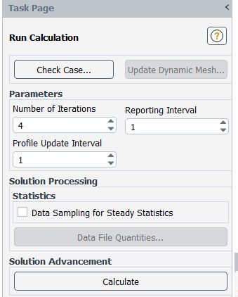

      Run Calculation -> Number of Iterations: 1
      The simulation runs as desired and is obviously much faster than the setup (Particle Time Step Size:1e-8/No of Steps:1/DPM Iteration Interval:1/Number of (Fluid) Iterations:1e6).

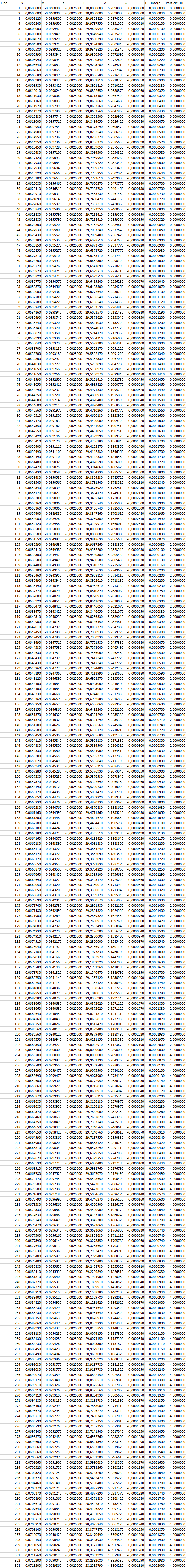

      I have sorted the printed data in "particleposition_1.txt" at first by Particle ID (last column) and second by P_Time(p) (second column from the right).

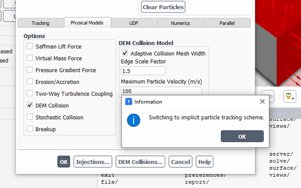

      According to the Theory Guide and this Information
      The Euler implicit discretization is used.
      I guess, this is the reason for the entries with P_time(p) different from Particle Time Steps (0,00001/0,00002/....).
      Is this assumption correct? If so, I still wonder why the number of "in-between" entries varies?
      Another thing I am not sure about are the rows where the fluid iterates (@N*5*10e-5).
      For instance, in row 24-26, at P_Time=0,00005s there are three entries.
      Compared to row 76-77, at P_Time=0,00015s where there are only two entries.
      Could you explain me what (particle time step/fluid iteration/implicite euler/ anything else?) and how influences the number of entries in my txt-File created by my UDF?
      Or, to sum up my problem:
      I want to get the values of the particle (x,y,z,u,v,w) at each particle time step. Am I right if I sort my entries by Particle_ID, then by P_Time from top to bottom and always take the LAST row for the relevant particle time steps?
      For Particle_ID=0 this would be for example row: 1, 5,10,15, 20, 26 , ?
      Here, do I need two entries for the P_times where the fluid iterates?
      Thank you again for your time!

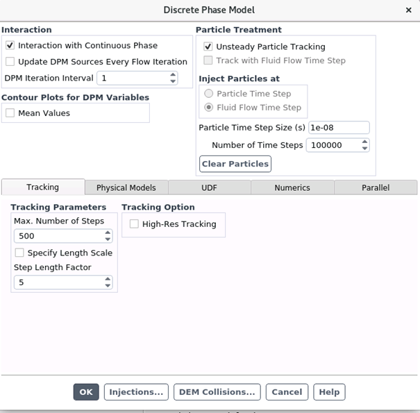

      I have calculated a Collison time for the spring dashpot model t_coll=1,09e-6s which led me to a particle time step size of 1/20*t_coll=5,45e-8s.
      Therefore, I want to set the particle time step size: 1e-8s, to get the right amount of overlap (soft sphere) and do not get ÔÇ£unphysicalÔÇØ collisions.

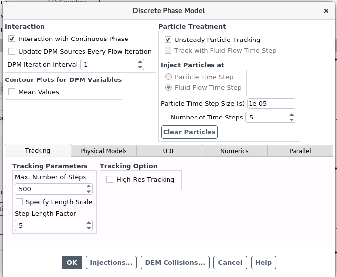

      If I have understood it right, the number of time steps/Particle time step size define, how many particle iterations happen during one fluid iteration and also determine the time frame of 1 fluid iteration (fluid iteration time = no of time steps* Particle time step size).
      My thought was, that ÔÇ£Tracking ParametersÔÇØ do not have an influence on the collision and that for the correct soft-sphere-overlap of the particles only relevant parameter is the Particle time step size.
      I interpreted ÔÇ£Max. Number of StepsÔÇØ as a parameter to prevent recirculation and ÔÇ£Step Length FactorÔÇØ according to the user guide as a factor ÔÇ£roughly equivalent to the number of time steps required to traverse the current continuous phase control volumeÔÇØ and therefore I kept the default value (5). Both parameters related with particle-fluid-interaction and not relevant for the DEM collision.
      My guess was that the particle time step size is smaller than the time step restrictions of ÔÇ£Tracking ParametersÔÇØ and therefore the particle time step is used for calculation.
      Maybe I misunderstood something here?
      However, my idea was to use these settings:
      If I got it right, these settings mean that 1 fluid iteration is calIculated, and then 100000 particle iterations with a time step of 10e-8s are calculated, meaning that with 1 fluid iteration I get a total simulation time of 0,001s.
      With a particle initial speed of 30m/s the particle then travels about 0,001s*30m/s=0,03m, so that I need roughly 15-20 fluid iterations (0,015-0,02s simulation time) for my particles to leave the domain.
      Fluid iterations take a lot longer than the particle iterations and since I have a converged fluid solution already, it would be great to use the settings above (to speed things up).
      I want to inject particles via file injection/repeat interval in a constant manner, to get a steady fluid solution with unsteady particles.
      To check if this would work, I played around a bit and encountered the problem with the particle data export, leading to my post in the forum.

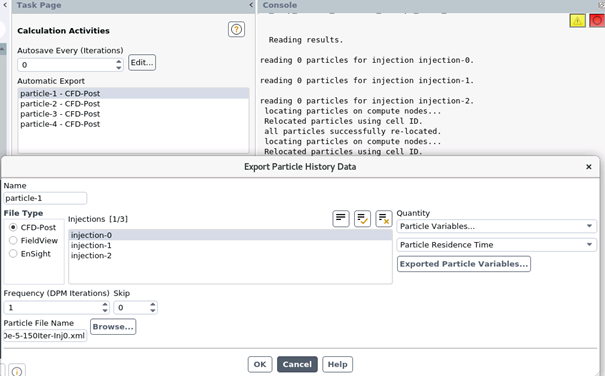

      I export the particle data like this:
      Calculation Activities->Automatic Export->Create->
      A quick simulated example, with a particle time step size: 1e-5/ particle time steps: 800/ 2 fluid iterations (Simulation Time 1e-5s*800*2=0.016s) shows this in CFDPost:
      Apparently, the particle data is only exported every fluid iteration and useless in this case because I want to investigate the collisions at the wall on the right and not just lines between start point and end point.
      I have not found a way to export the particle data every particle iteration, which is why I came up with the mentioned UDF idea.
      If there is a way to solve my problem without an UDF would be even better, if not at least I can work with the DPM_Scalar_Update_UDF and sorting the time.

    • DrAmine
      At particle time step / particle iteration you require UDF for Export
