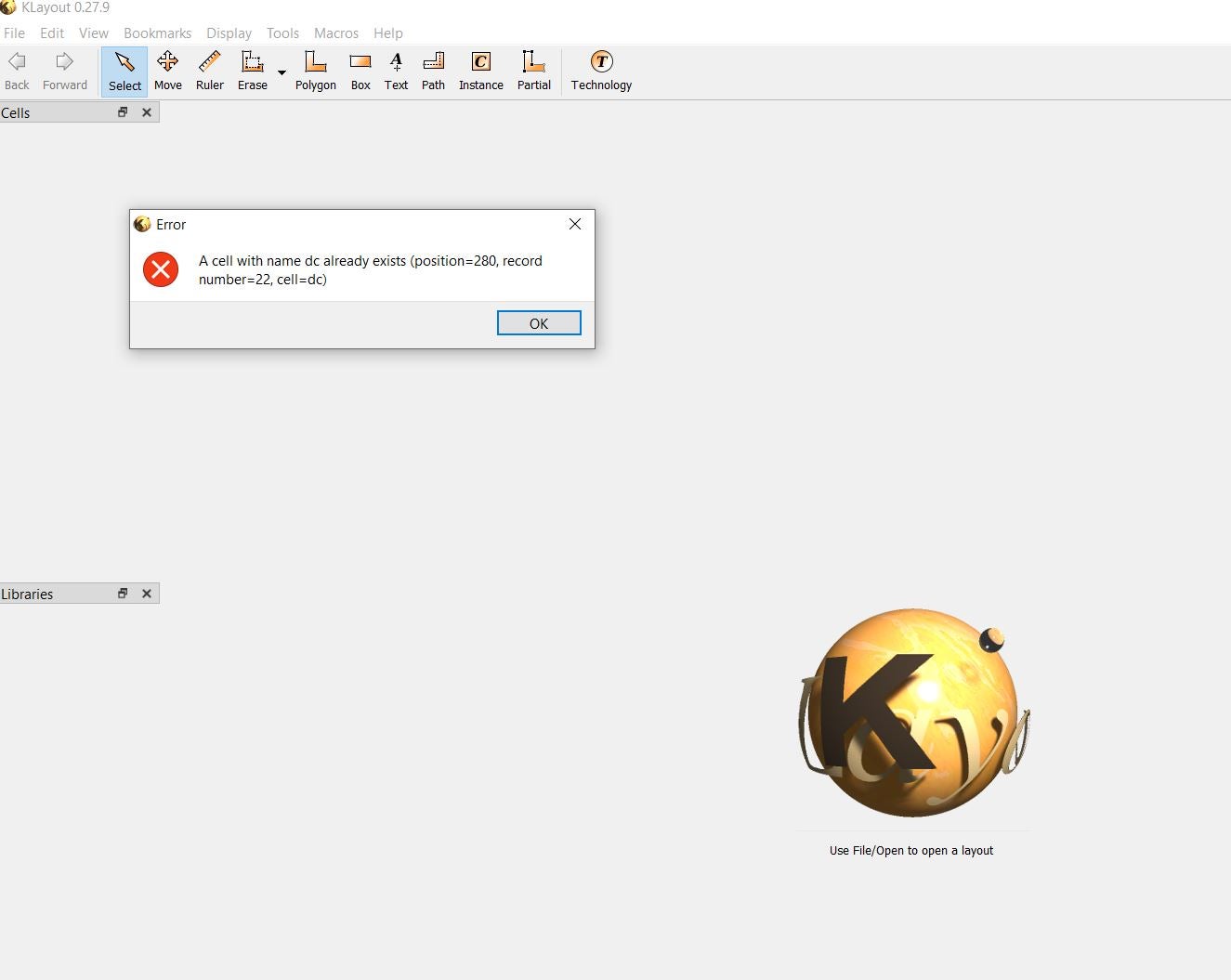

I am getting an error in Klayout
I changed the name dc to dc1 and dc100 etc in lumerical , the error is still there.
out. Could you tell me the reason.

Ansys EmployeeSince this is the 3rd party tool, it can be difficult for us to support. Maybe you can file a feature request to include KLayout in Lumerical product. Vote new features, and file your feature request
From the error message, it seems the GDS file has more than one "dc".
Please first check if you can upload it into Lumerical GUI.
