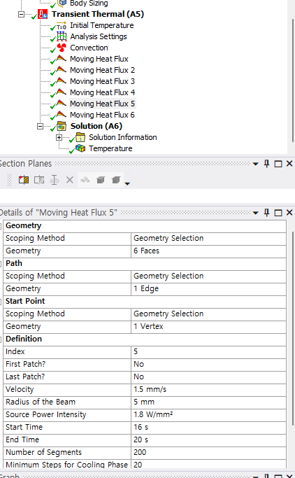

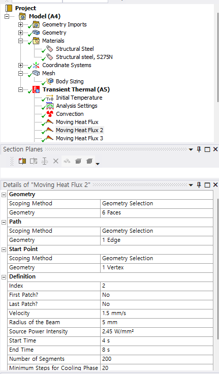

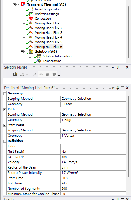

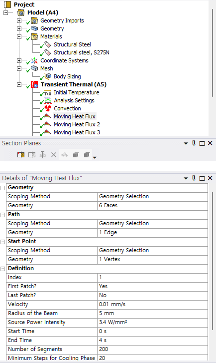

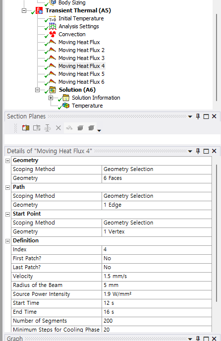

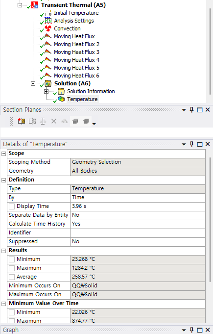

      We are checking the amount of change in temperature conditions due to the movement of the heat source.
      During transient thermal analysis, we completed the analysis of temperature changes using moving heat flux.

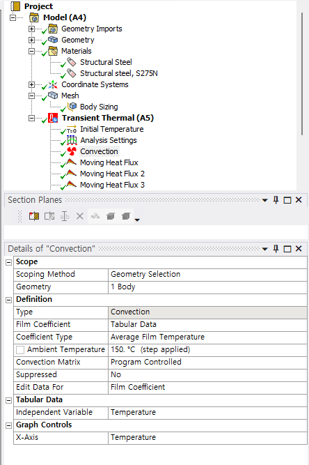

      Additionally, we will try to analyze by changing the environmental temperature (indoor temperature 22℃ -> 130℃).
      Even if you change the ambient temperature among the tubular data of convection, there is no change in the analysis temperature value (0.1~1℃ change).
      I would like to change the environmental temperature and check the change in speed and temperature during heating and cooling
      What should I do??

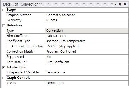

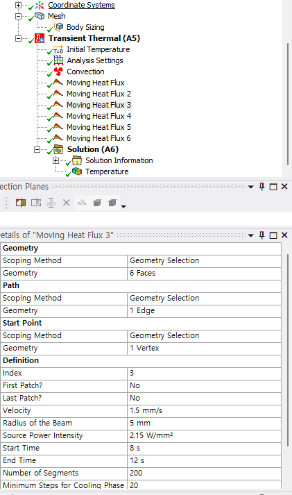

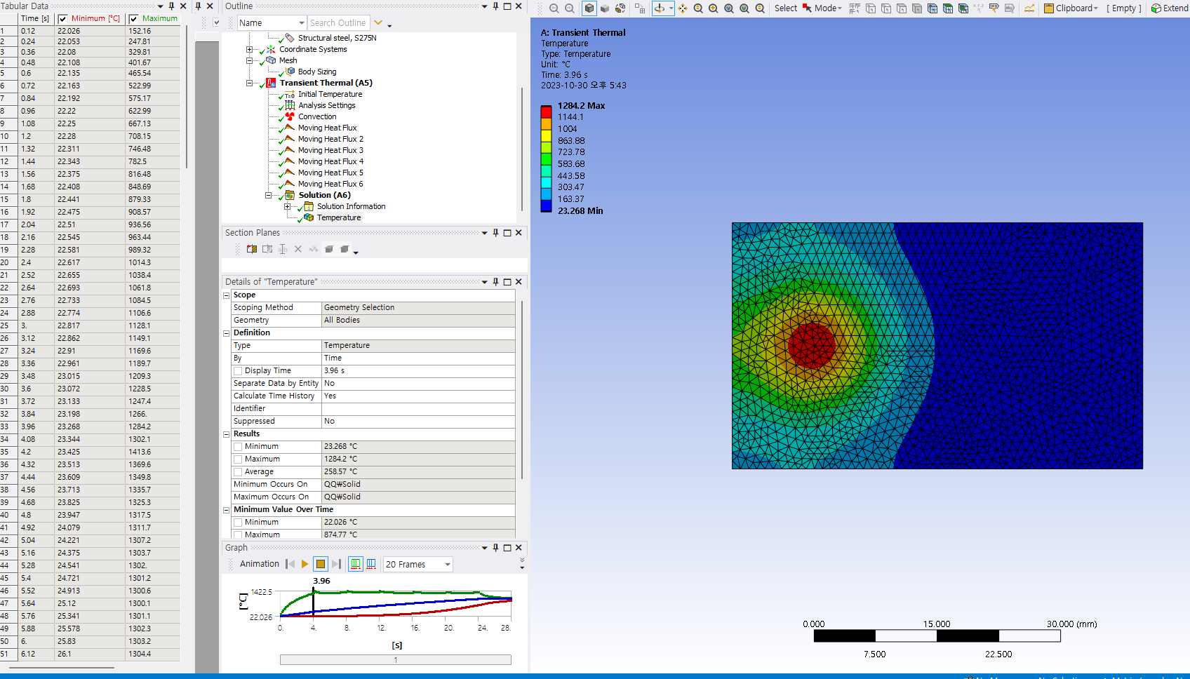

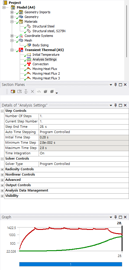

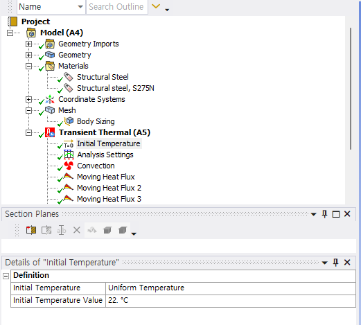

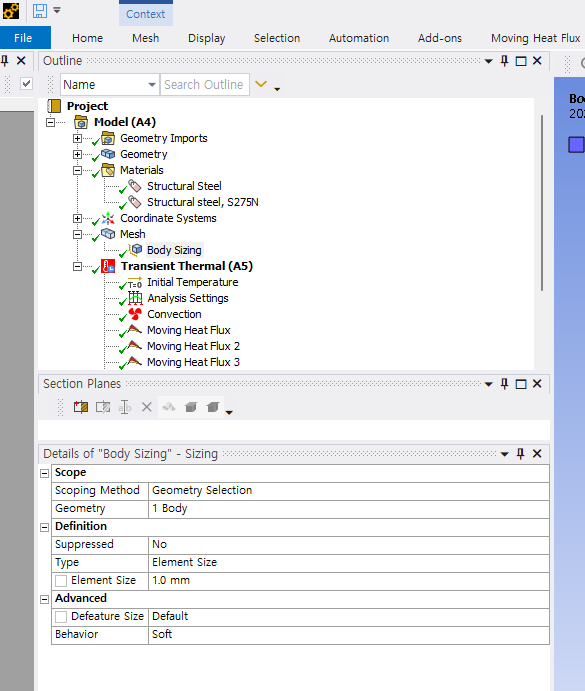

      • Chan Hyung Ryu
        These are the only boundary conditions I adjusted during transient thermal analysis, and I did not consider any additional load. This is because it was conducted to check the value of temperature, not thermal deformation.
        The material is Structural Steel.
