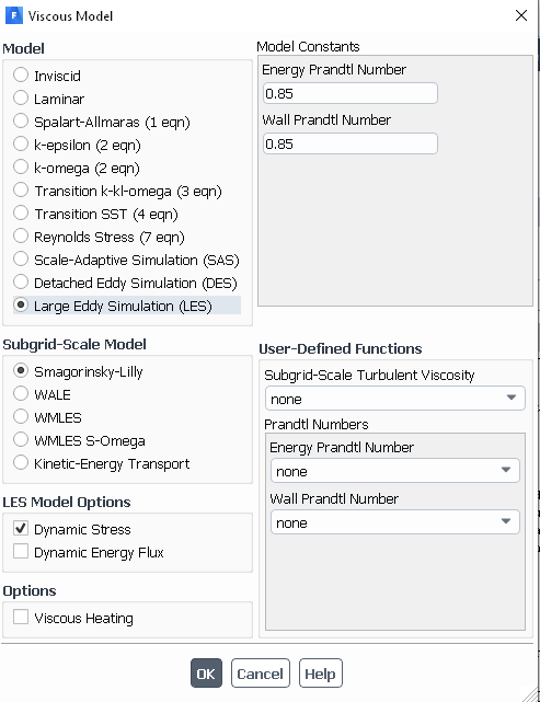

I have a question concerning the Dynamic Smagorinsky-Lilly LES Model. How can I enable it in Fluent turbulence panel?
I read the theory guide and I think I should enable the option "Dynamic stress" but I am not sure because the theory guide does not give information about those models.
Could anyone give me some guidelines?
Thanks in advance.
Regards.
January 9, 2022 at 9:05 amai0013
SubscriberYes, by enabling the "dynamic stress" checkbox Fluent sets the dynamic Smagorinsky model. Note that you are no longer asked to provide a value for Cs. Now Fluent calculates it automatically by applying a second filtering (at a test level) and using Germano's Identity.
You can run the case and display the 'subgrid dynamic viscosity constant'. Note that the contour will vary locally
