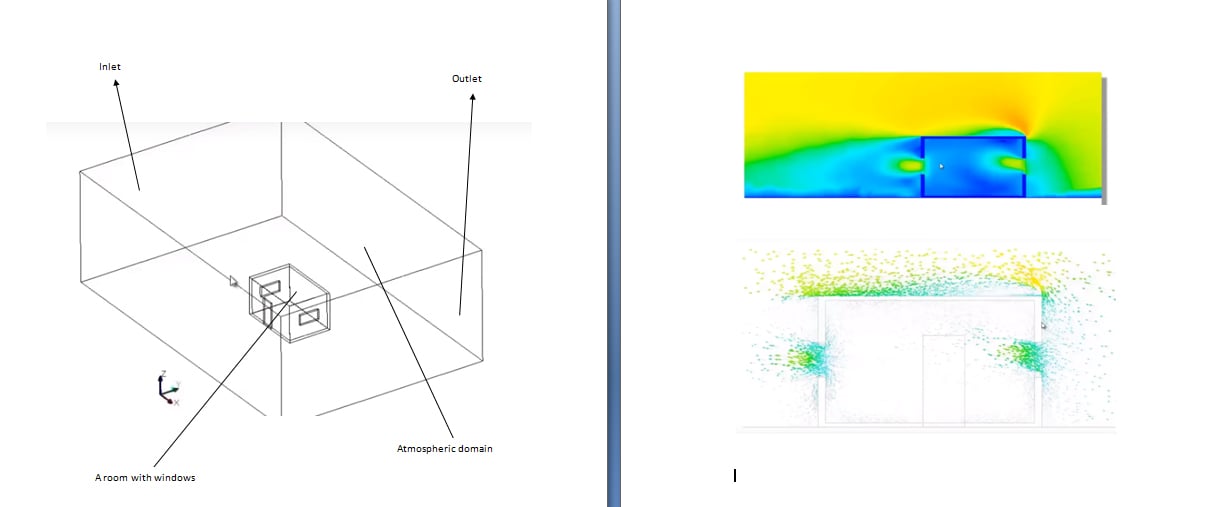

      My study is to find out the air ventilation rate inside the room. So I need to find out the air pressure and velocity on the windows.
      My queries are:
      How do I draw an Atmospheric domain with the room inside?
      How do I define the boundary condition of both the domain and room?
      I need to produce the following images.

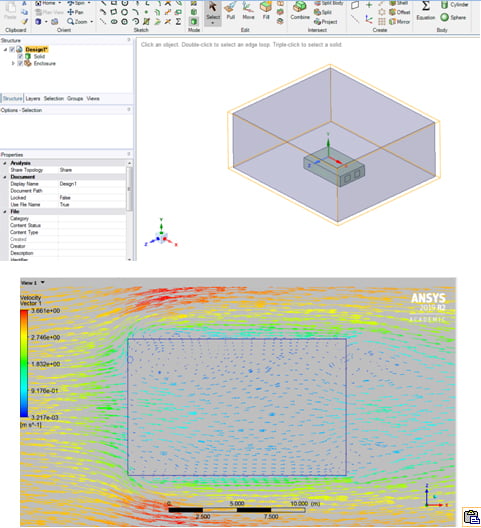

      I drew one solid box and drew 2 windows with surfaces.
      Then put the enclosure.
      Set the shared topology and suppress for physics.
      In the meshing, I named the faces containing windows “interior” and inlet and outlet face on the atmospheric domain.
      I didn't succeed. Could you please explain step by step.

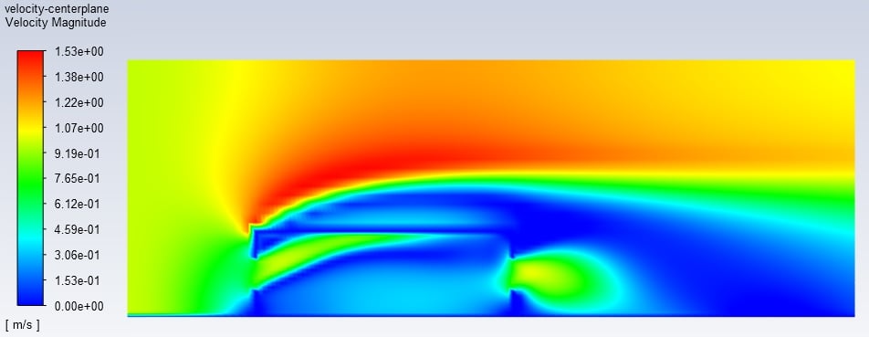

      Here is a completed simulation at 1 m/s inlet air velocity on a 1/2 symmetry model.

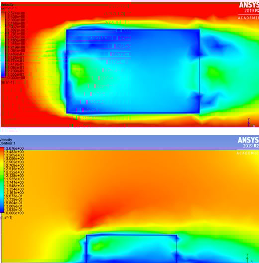

      Thanks peteroznewman. I can’t figure out the windward window sharply (like yours). The Leeward window turned out okay. where am I gone wrong in my data input??

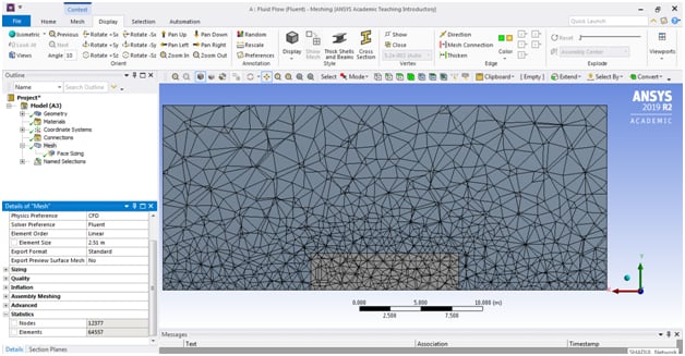

      Maybe you haven't used small enough elements? In Meshing, take a Section view through one of the windows. Reply with an image inserted to show the size of the elements. There is a button on the section view to show whole elements, turn that on.
    • pssjn
      On the Section plane there's a triangle/tetrahedron button, that'll show full cells which is easier to see.  However, in this case one of the problems is mesh resolution. Put a volume sizing on the room so you've got about 6 cells up the height of the window. That may still not be fine enough but will do for now.
