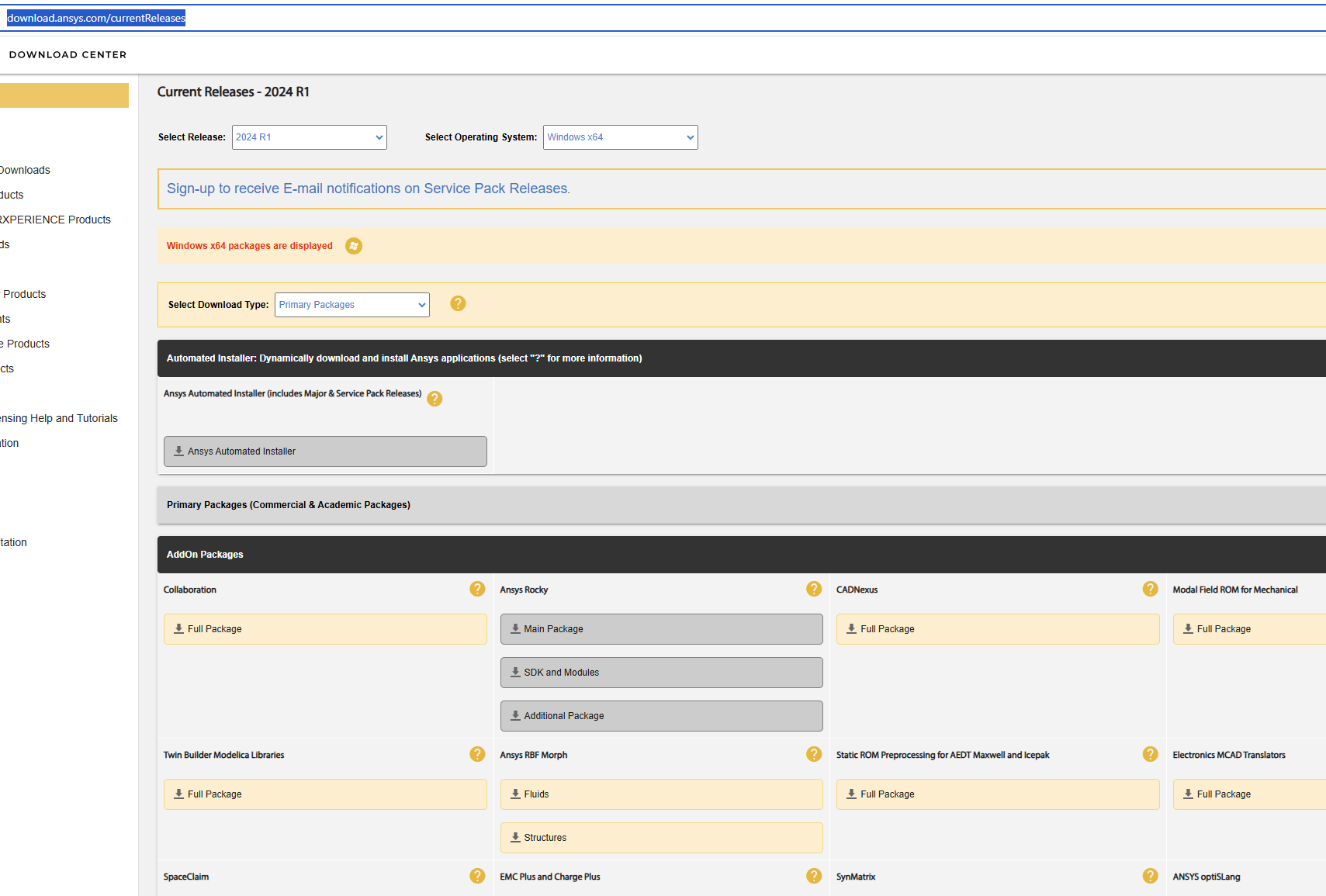

I am trying to download SDK modules of rocky based on what is provided here
https://www.youtube.com/watch?v=UMM-63fl3Lk
Can anyone please help me download this?
https://innovationspace.ansys.com/knowledge/forums/topic/ready-to-use-module/
I go here and it takes me to this pageÂ
https://download.ansys.com/currentReleases
I do not see rocky ready to use module anywhere.
January 31, 2025 at 2:47 pm
Shyam Prasad V Atri
SubscriberNever mind, I found a way to download it.Â

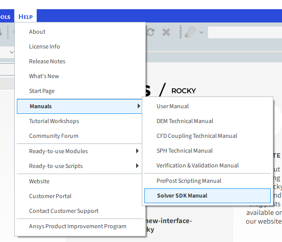

SubscriberI looked at the manual. The equations are present. But in the src codes I do not see the equations. I only see the DLL files.
I want to see the equations in src code. please let me know if those are available?

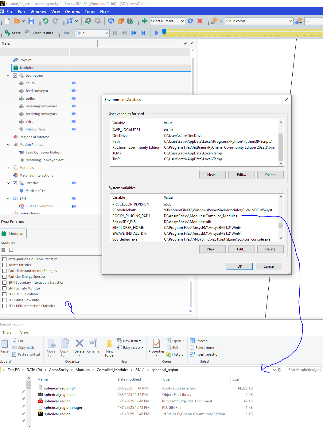

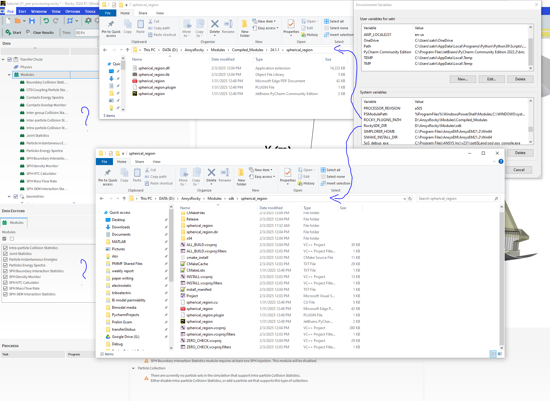

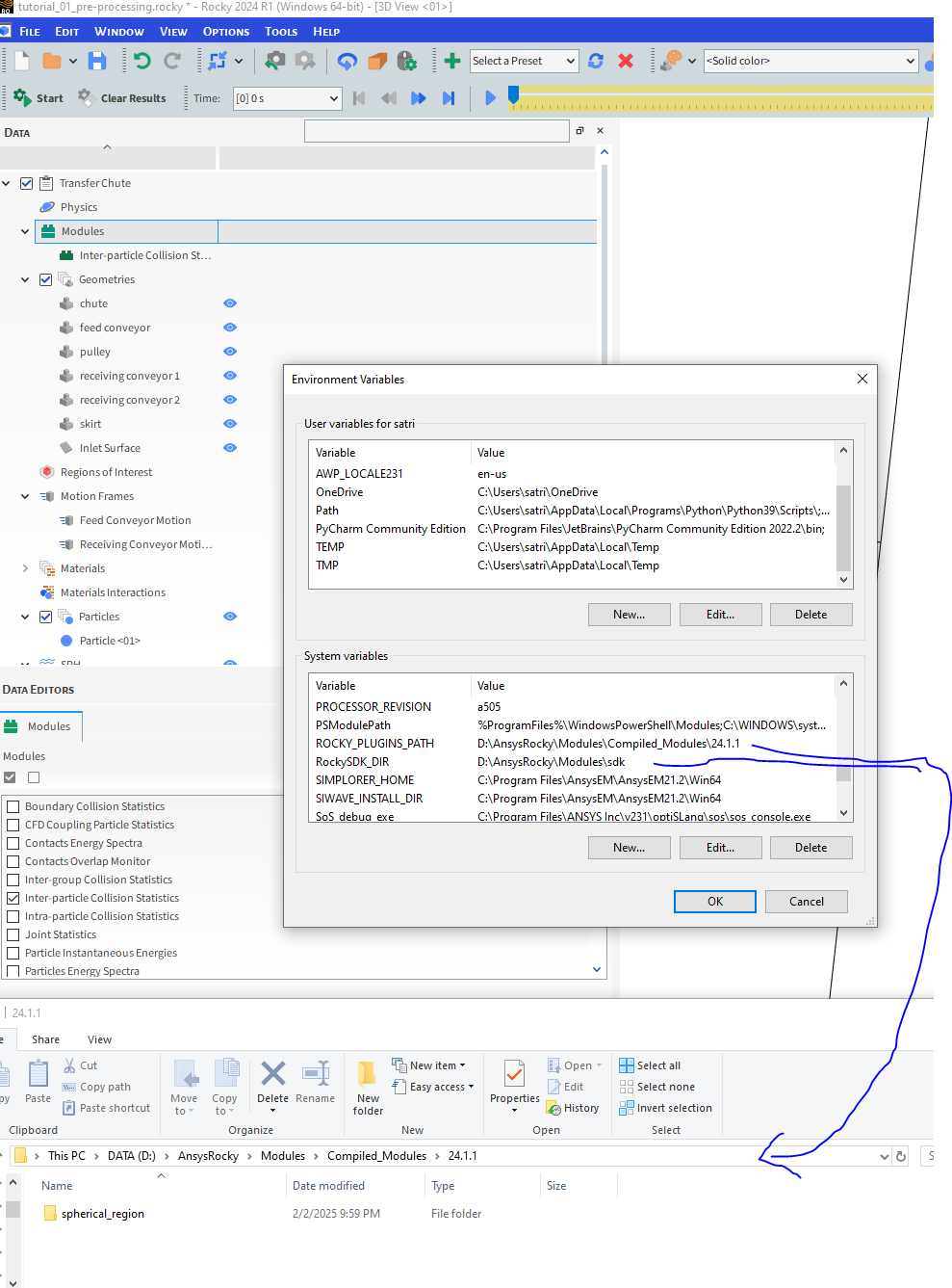

February 3, 2025 at 3:37 am
February 3, 2025 at 4:25 am
Shyam Prasad V Atri
SubscriberI even removed the 2.4.1 in the env variable and tried it again. still I do not see the compiled module.
Note: 1) I am not getting any errors while compiling.Â
     2)I am not changing anything in the cmakeList.txt file.
    3) I do not have rocky open while compiling. I am opening it after everything is compiled.
    4) I have restarted the computer after defining the env variable
I still cannot see the compiled module in rocky
February 3, 2025 at 4:56 am
Shyam Prasad V Atri
SubscriberI am compiling rocky with these commands
cmake -DCMAKE_GENERATOR_PLATFORM=x64 spherical_region
cmake --build . --config Release
cmake -P cmake_install.cmakeand I still cant see the new custom module

February 3, 2025 at 2:40 pm
February 3, 2025 at 3:48 pm
victor.garbe
Ansys EmployeeDear Shyam, you have to restart Rocky for the module to show in the module list. Please make sure you followed all the steps as depicted in the Chapter 23: Tutorial - SDK and API: Solver tutorial.
February 3, 2025 at 3:52 pm
Shyam Prasad V Atri
SubscriberDear Victor, I have restarted Rocky multiple times. I have also restarted my computer multiple times. Still i see the same problem. I have followed all the steps outlined in Chapter23
February 3, 2025 at 3:55 pm
victor.garbe
Ansys EmployeeI see you're using the 2022 Visual Studio version. In order to compile 2024 R1 modules, you have to follow the correct version of the tutorial, which uses Visual Studio Build Tools 2019.
Please check out the Chapter 23: Tutorial - SDK and API: Solver tutorial which is specific to the 24.1.1 version, and make sure you follow the correct steps.
February 3, 2025 at 5:18 pm
Shyam Prasad V Atri
SubscriberHello Victor
I completely uninstalled Visual Studio 2022 and installed only 2019. I uninstalled NVIDIA, too, and re-installed it. I restarte my computer two times.Â
After this I compiled the program.
I opened rocky after compiling.
Even now rocky is not picking up the new module.
I restarted my computer again and opened rocky. Even then I don't see the module.
I have followed everything given in rocky Tutorial 23.
I downloaded Visual studio 2019 from the link provided in the tutorial.
I don't know what to do now.Â
please see the log below and the screenshot from Rocky GUI.Â
February 3, 2025 at 5:20 pm
Shyam Prasad V Atri

  cmake_minimum_required or cmake_policy(VERSION).  This warning appears
  because target "spherical_region" links to some libraries for which the
  linker must search:   rocky20api-MD, rocky20addins-MD, rocky20-MD, rocky_logging-MD
  and other libraries with known full path:
   C:/Program Files/NVIDIA GPU Computing Toolkit/CUDA/v11.7/lib/x64/cudart_static.lib
  CMake is adding directories in the second list to the linker search path in
  case they are needed to find libraries from the first list (for backwards
  compatibility with CMake 2.4).  Set policy CMP0003 to OLD or NEW to enable
  or disable this behavior explicitly.  Run "cmake --help-policy CMP0003" for
  more information.
 Call Stack (most recent call first):
  CMakeLists.txt:13 (cuda_add_library)
 This warning is for project developers.  Use -Wno-dev to suppress it. -- Generating done
 -- Build files have been written to: D:/AnsysRocky/Modules/sdk/spherical_region
   Creating library D:/AnsysRocky/Modules/sdk/spherical_region/Release/spherical_region.lib and object D:/AnsysRocky/
 Modules/sdk/spherical_region/Release/spherical_region.exp
LINK : warning LNK4098: defaultlib 'LIBCMT' conflicts with use of other libs; use /NODEFAULTLIB:library [D:\AnsysRocky\
Modules\sdk\spherical_region\spherical_region.vcxproj]
 spherical_region.vcxproj -> D:\AnsysRocky\Modules\sdk\spherical_region\Release\spherical_region.dll
 Building Custom Rule D:/AnsysRocky/Modules/sdk/spherical_region/spherical_region/CMakeLists.txtD:\AnsysRocky\Modules\sdk\spherical_region>
D:\AnsysRocky\Modules\sdk\spherical_region>cmake -P cmake_install.cmake
-- Install configuration: "Release"
-- Installing: D:/AnsysRocky/Modules/Compiled_Modules/24.1.1/spherical_region/spherical_region.lib
-- Installing: D:/AnsysRocky/Modules/Compiled_Modules/24.1.1/spherical_region/spherical_region.dll
-- Installing: D:/AnsysRocky/Modules/Compiled_Modules/24.1.1/spherical_region/spherical_region.plugin
-- Installing: D:/AnsysRocky/Modules/Compiled_Modules/24.1.1/spherical_region/spherical_region.py
-- Installing: D:/AnsysRocky/Modules/Compiled_Modules/24.1.1/spherical_region/spherical_region.pdfD:\AnsysRocky\Modules\sdk\spherical_region>
February 3, 2025 at 5:31 pm

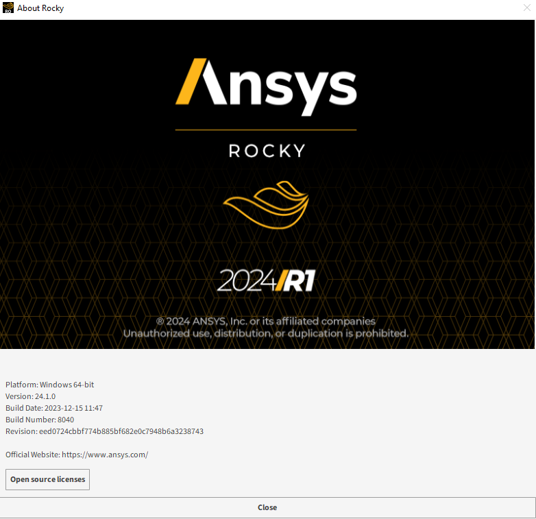

Ansys EmployeeShyam, could you open Rocky and go to Help -> About and print the "About Rocky" window that appears?
February 3, 2025 at 5:51 pm
February 3, 2025 at 5:53 pm
victor.garbe
Ansys EmployeeDear Shyam, this means that you have 24.1.0 version, and not 24.1.1 - please install the correct version through customer portal.
February 3, 2025 at 5:54 pm
Shyam Prasad V Atri
SubscriberI am using Rocky, which is provided by Ansys license at the university (North Carolina State University, NCSU).
February 3, 2025 at 5:55 pm
victor.garbe
Ansys EmployeeYes, but you're compiling for the 24.1.1 version and you have the 24.1.0 version installed. Please switch to the correct version in order to use the module.
February 3, 2025 at 6:00 pm
February 3, 2025 at 6:51 pm
victor.garbe
Ansys EmployeeDear Shyam, are you not able to upgrade to 24.1.1?
February 3, 2025 at 8:35 pm
Shyam Prasad V Atri
SubscriberI have requested the university to install the new version on one computer. but it might take a day or two.
So I thought that if I could get 24.1.0, it would be great.

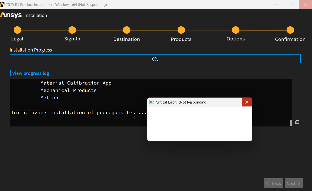

Shyam Prasad V Atri

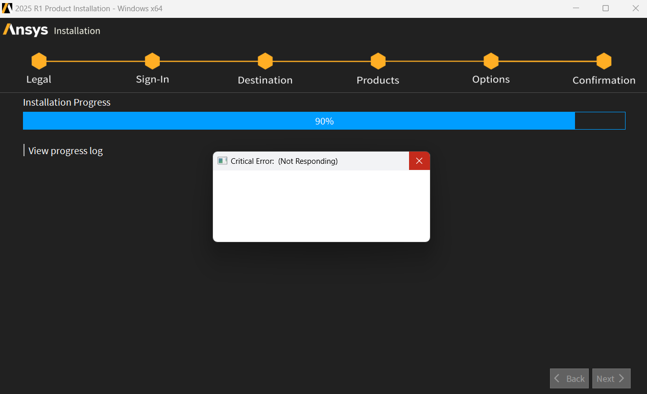

SubscriberHey I am trying to install rocky 25r1 but I am having issue downloading it on my personal computer. I am trying to install it with the student version download. I extracted the file installed it and restarted my computer. But I do not see any Ansys products. Please tell me if SDK works with student version?
February 4, 2025 at 2:15 pm
Shyam Prasad V Atri
SubscriberAnd why am I not able to install it on my computer? I followed the instructions given on installation pageÂ
February 4, 2025 at 2:37 pm
victor.garbe
Ansys EmployeeTo download Ansys Student that includes Ansys Rocky as part of the bundle, visit here. It should be a 15.4 GB file, containing all Ansys Student applications.
ÂÂ -
February 4, 2025 at 2:42 pm
Rob
Forum ModeratorAnd make sure to read the text telling you to download some extra files for Rocky.Â

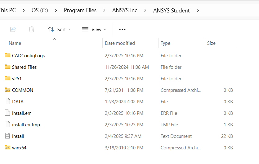

SubscriberThis is the installation log
Â>>>--------------------------------------->Start Installation: Tue Feb 04 14:09:53 2025Revision: 2025 R1ÂPlatform specifics:  WindowsUsername of Installer: AAAAAAA\shyamUser Has Administrator PrivilegesC:\Users\shyam\AppData\Local\Temp\ans_install_tmp8660\instcore.exe -usetempdir C:\Users\shyam\AppData\Local\Temp\ans_install_tmp8660 -launchdir C:\Users\shyam\Downloads\ANSYSACADEMICSTUDENT_2025R1_WINX64 -adminInitial mount directory:  C:\Users\shyam\Downloads\ANSYSACADEMICSTUDENT_2025R1_WINX64Installation Directory:  C:\Program Files\ANSYS Inc\ANSYS StudentÂWindows x64   Design   Fluids     Ansys Dynamic Reporting     CFX (includes CFD-Post)     Chemkin     EnSight     FENSAP-ICE     Fluent (includes CFD-Post)     Forte (includes EnSight)     Model Fuel Library (Encrypted)     Polyflow (includes CFD-Post)     Reaction Workbench     Rocky     TurboGrid   Geometry Interfaces     Discovery Geometry Interface   Optical     Speos     Speos RPC   Structures     Aqwa     Autodyn     Material Calibration App     Mechanical Products     MotionÂInitializing installation of prerequisites ...The installation will copy the prerequisite setup files from the media in case you need to reconfigure later or if you need to configure client machines for products installed to a network share.This may take a while ...Successfully copied prerequisites from media.ÂYou don't need to install any prerequisites. -
February 4, 2025 at 8:24 pm

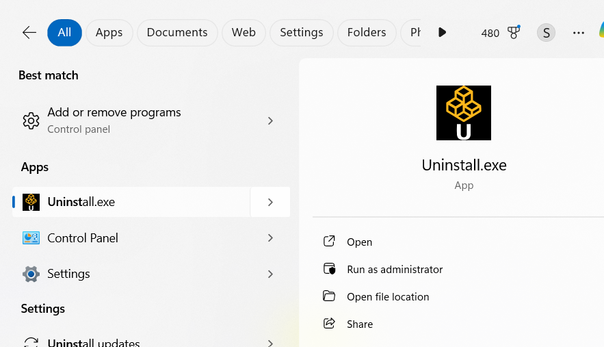

George Karnos
Ansys EmployeeHi,
What is meant by :
I am not able to run the uninstaller program to uninstall ansys.Are you receiving an error?
What happens if you right click on:
Start->Ansys 2025 R1->Uninstall Ansys 2025 R1
Then choose run as administratorYou can also run it by right->click on:
c:\Program Files\Ansys Inc\Ansys Student\v251\Uninstall.exe
If you rename the directory c:\Program Files\Ansys Inc\Ansys Student
to c:\Program Files\Ansys Inc\Ansys Student-safeThen delete the following environment variables:
AWP_LOCALE251=en-us AWP_ROOT251=C:\Program Files\ANSYS Inc\ANSYS Student\v251 ANSYS251_DIR=C:\Program Files\ANSYS Inc\ANSYS Student\v251\ANSYS CADOE_LIBDIR251=C:\Program Files\ANSYS Inc\ANSYS Student\v251\CommonFiles\Language\en-us P_SCHEMA=C:\Program Files\ANSYS Inc\ANSYS Student\v251\AISOL\CADIntegration\Parasolid\PSchema
That should also allow you to perform a clean installation.

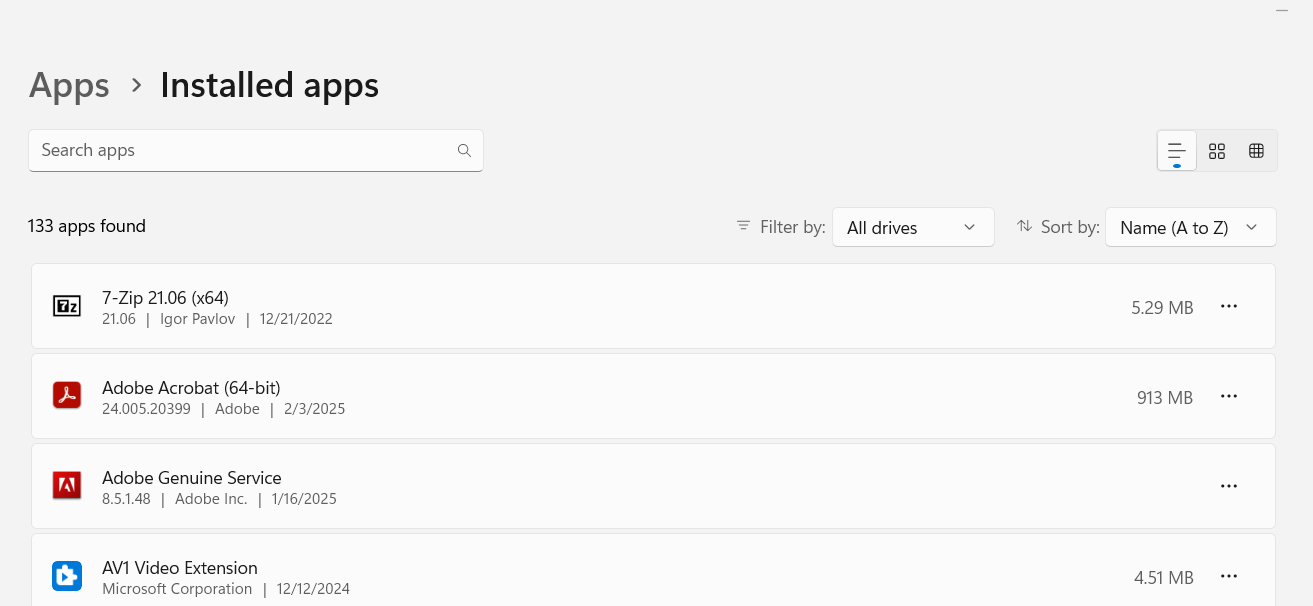

#IMPORTANT: Always right-click and choose run as administrator when running any uninstall or setup executable.
Ansys 2025 R1 will not be displayed in the APPS->Installed Apps Window. -
February 4, 2025 at 8:31 pm

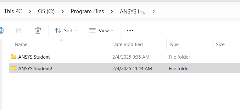

Shyam Prasad V Atri
SubscriberÂ
I got frustrated with this installation process, causing so many issues, and deleted the entire folder from C drive.
I was running in admin mode.
I don’t see any of the environment variables that you have listed.
Please let me know how I can proceed from here. I don’t have an uninstall option anymore in start menu.
February 4, 2025 at 11:30 pm
Shyam Prasad V Atri
SubscriberHello George,
I am still facing the issue. Can you please tell me how I can install ansys?
I deleted the old installation completely from C drive. Now I do not see any uninstall option. But I am not able to install it too. So I don't know what to do.

February 5, 2025 at 12:54 pm

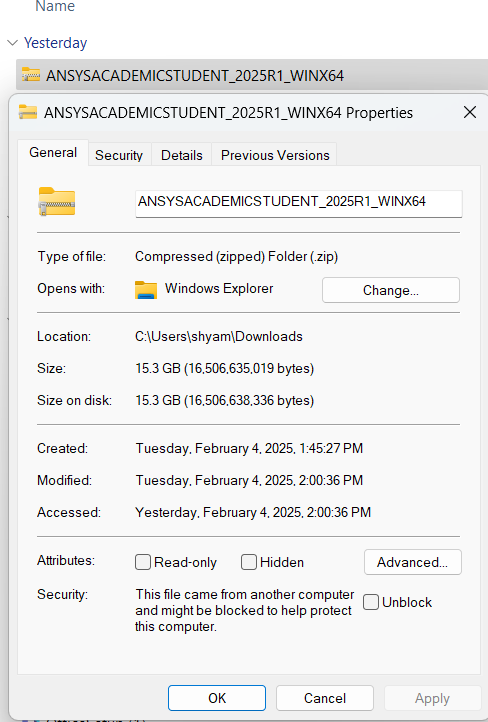

George Karnos
Ansys EmployeeHello Shyam,
Do you have any Virus protection that may be blocking installation?
What is the size of the ANSYSACADEMICSTUDENT_2025R1_WINX64.zip file that you have downloaded?
16,119,761 KB
When you run the installation and look at Task Manager, do you see
instcore.exe using cpu/memory? Sort by CPU
Do you see any antivirus using cpu/memory as well? -

Shyam Prasad V Atri
SubscriberHelloÂ
I am trying to follow up on this one. I am still not able to install ansys2025r1 student on my laptop. Please let me know how to fix this
